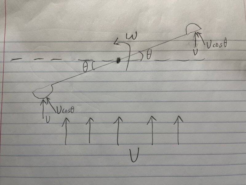

The professor recommended that our first step be to find a formula that estimates the instantaneous drag on the cups as a function of the rotation angle, θ. The first thing I did was draw a diagram of the setup. I'm assuming that the fluid velocity relative to the wind is what's most important, as that's what's causing the "drag" on each of the anemometer's cups. I also set up my equation for the drag force in such a way that only the component of the wind speed normal to the "face" of the cups are considered. I'm assuming that this is valid, though if there's a problem with that approach then please point it out to me!
Anyways, my initial force equations look like this. Note that "1" subscripts refer to the cup which has its opening facing the incoming wind (and is therefore rotating "with" the wind), and "2" subscripts refer to the cup with is faced in the opposite direction, and is therefore "fighting" the wind at any given angle.
\begin{align*}
F_d1 & = \frac{1}{2} \rho A c_{d1} (v_{rel1})^2 \\
F_d2 & = \frac{1}{2} \rho A c_{d2} (v_{rel2})^2
\end{align*}
Note that this doesn't account for the drag acting on the rotating rod between the two cups. Expanding it out a bit, accounting for the "relative" wind speeds as I mentioned earlier:
\begin{align*}
F_d1 & = \frac{1}{2} \rho A c_{d1} (U \cos(\theta) - R \omega)^2 \\
F_d2 & = \frac{1}{2} \rho A c_{d2} (U \cos(\theta) + R \omega)^2
\end{align*}
The values for cd are provided by the textbook. I've listed them in the "Relevant Equations" section.
I don't feel terrible about this approach, but I do admit that my logic might be kind of shaky. Due to the fact that the anemometer is rotating, technically a "1" cup will become a "2" cup and vice-versa after each 180-degree rotation of the device. I'm not sure if this hurts the validity of my equations.
The bigger problem I have with what I've done, is the fact that I don't think I've fully solved the "first" step of the problem. Sure, it's a formula for drag force with respect to theta, but it also includes omega - a non-constant. Not sure what to do about that.
I also tried to make a formula for the net torque of the system:
\begin{align*}
M &= L (F_{d1} - F_{d2}) \\
&= \frac{1}{2} \rho R A ( 1.4(U \cos(\theta) - R \omega)^2 - 0.4(U \cos(\theta) + R\omega)^2 )
\end{align*}
And that's about where I'm at right now. I feel like I probably want to find a formula for the angular velocity as a function of theta, but I've been playing around with it for a bit and I'm really not sure how to do that, and I kind of feel like I've hit a dead end right now. A classmate who's working on the same problem has said that he's going to try finding a function of the drag coefficient with respect to theta, as opposed to what I've done. Might his approach be better?
Any tips would be much appreciated!
That rod becomes elliptical over much of the rotation.
The provided values of Cd are only valid for the tests completed in a wind tunnel for the cups being positioned perpendicularly to the airstream.
Therefore, those are only valid for those instantaneous positions.
As each cup rotates from 1 to 2, both change, the cross-section facing the wind and that Cd.
The Cd values for each position between 1 and 2 can only be assumed, or determined in a wind tunnel.
What angle is represented by omega?
Which is why I clarified, and showed in the equations I derived in the OP, that I specifically derived the drag force equation I found to be in terms of the perpendicular components of the wind, using a cos(theta) term.
Like I said in the OP, I'm open to the idea that my line of thinking there is flawed, but since I've solved other vaguely similar problems using the same idea, I'd like to hear an alternate suggestion if you think there's a better procedure that I'm overlooking.

Fair point, though I ran this by my professor and he encouraged me to use those values given in the book. I think we're supposed to assume that we're essentially designing this thing for a wind tunnel.
I've attached a photo of a cleaner version of my hand-drawn sketch of the situation. Essentially, it's just an angle of rotation for the anemometer itself. Omega is the angular speed, which the problem states should be constantly changing as a function of theta.
