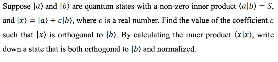

I was attempting the following past paper question below:
I have found a value for the coefficient c and I think I have calculated the inner product of <x|x>. I've attached my workings below. But I'm not sure what to do next to answer the last part of the question which asks about finding an orthonormal state to |b>. Am I right to say that <a|a> and <b|b> are equal to one or is my <x|x> calculation wrong?
