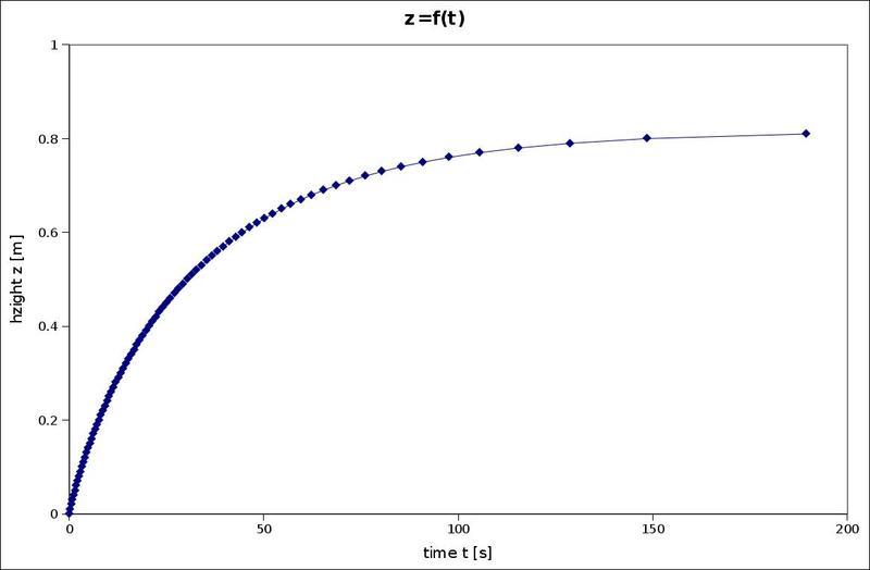

I looked a bit further on the equation and the solution and came up with the following observations.
*) Is the following equation the correct physical one?
[tex]
\frac{dz}{dt} = \frac{\dot{V}}{A} - \frac{A}{A_0}\sqrt{2\cdot g \cdot z}
[/tex]
[tex]A[/tex] the section of the vessel
[tex]A_0[/tex] the section of the hole
[tex]g[/tex] gravitational constant
[tex]\dot{V}[/tex] the in flow of liquid
Thus giving:
[tex]
a=\frac{\dot{V}}{A}
[/tex]
[tex]
b=\frac{A}{A_0}\sqrt{2\cdot g}
[/tex]
In case this is correct, you get the following numerical equation (g=9.80665m/s^2)
[tex]
\frac{dz}{dt} = 0.04 - 0.04428690551393 \sqrt{z}
[/tex]
*) For large time we will have a limiting height equal to:
[tex]
\frac{dz}{dt} = 0 \qquad z_0=\left(\frac{a}{b}\right)^2
[/tex]
Which is thus
[tex]
z_0=0.81577297038234m
[/tex]
*) The solution I gave is only valid for [tex]z<z_0[/tex], giving infinite time to reach this height [tex]z_0[/tex].
*) A graphic of this function is now:
This looks like the first one you gave.
Hope this helps.

Hi,
[tex]
[/tex]
Not quite, your second term is incorrect. It should read:
[tex]
\frac{dz}{dt} = \frac{\dot{V}}{A} - \frac{A_0}{A}\sqrt{2\cdot g \cdot z}
[/tex]
Thus giving:
[tex]
a=\frac{\dot{V}}{A}
[/tex]
[tex]
b=\frac{A_0}{A}\sqrt{2\cdot g}
[/tex]
The rest of your analysis follows nicely. I've just come back to this after eating and I must have typed something wrong when plotting, as it indeed behaves just fine within the limits [tex]0 \leq z \leq z_0[/tex].
Cheers,
James.
