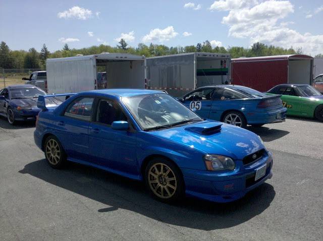

Ask a mechanic, Cy. The maps are available to change all kinds of performance/efficiency parameters. I bought the module because I understand ICE technology and how to troubleshoot them, and I didn't want to pay the H-D place hundreds to reprogram the stock module every time I wanted to try something different. You can change a LOT of stuff within the design parameters of the engine. Change fuel flow at certain RPMs and you have changed consumption. Change EI advance, and you have changed some more parameters. Did you know that modern cars are fitted with throttle-position sensors? That's so the computer will know the difference between the acceleration you are demanding (with the accelerator pedal) and what you are getting, so it will (according to the map) adjust fuel flow and ignition timing accordingly. For instance, your ignition timing might be advanced during hard acceleration and retarded somewhat when you are cruising at-speed. There's nothing sacred about that chart, though it is a nice graphic on how your automatic transmission should shift to optimize fuel economy.
  • #50
This is exactly what I'm talking about. If you change the fuel flow at a given RPM, you will change the PSI on the y-axis. Once you pick an RPM and PSI value, you are stuck with the fuel flow rate. What you are doing is when you reporgram it is to use a non-optimal curve along the map of the engine. I don't see how you are changing the map itself.

You're missing the point, Cy. You can easily run engines over-rich or over-lean at any RPM (with possible detrimental effects to fuel-consumption and/or engine life). The idea that an engine MUST consume a certain amount of fuel at a certain RPM regardless of load, ignition timing, etc is a gross over-simplification. I've been tweaking ICEs for about 40 years now. If you don't believe me, ask a mechanic.
When I bought my old Wide-Glide, I was getting about 40-45 mpg. After fitting it with better-scavenging pipes, low-restriction air filter, high-flow petcock and filter, and rebuilding the S&S Super E racing carb with a Yost Power-tube for improved atomization, I could get 50+ mpg riding through the mountains 2-up, and the bike ran like a scalded cat. Many of the parameters that I had to adjust manually on that bike can be tweaked through mapping control modules these days. BTW, getting reasonable low-speed performance out of a large-bore butterfly carb is somewhat of an art, which is why you see many older modded H-Ds smoking on acceleration at low RPM. Air-speed across the main-jet venturi is insufficient to atomize the fuel properly, so it is not burned completely. Nothing wrong with the design - just poor skills on the part of the person who tuned the bike and thinks that oversized jets are the answer for performance gain.
  • #52

EDIT: and I totally load different maps. At the track I have one that keeps the engine rich and ready for hard driving. For daily driving I switch back to something closer to stoichiometric, and for winter (i.e. now) I have a fuel-miser map (because I don't do a lot of hard driving in the winter).
