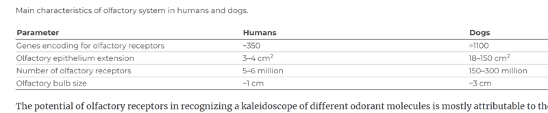

Because a well trained detection dog is better. End of story. Maybe someday a machine will be able to do what dogs can. People are working really hard on this problem, especially for remote detection (like, there's a bomb over there because my laser can see it's smell in the air). The odor signature (i.e. GCMS plot) of heroin or C4 is a pretty complicated thing. Does your machine have 1000 chemical sensors integrated with a brain that also controls the motion, sniffing, and rapid response coupling those features? No, not yet? Maybe someday.

I tell my students if they want to get an impression of the dog's umwelt consider switching your visual acuity and processing with your sense of smell. That is the dog's world; smell first, vision second (sort of).

The sense of smell is the poor relation. We don't even know the basics of how it works. We do have mass spectrometers and such.

Yes, but we also don't know how to interpret the MS data in real world environments. In the lab there's a ton of sample preparation before the MS machine. You can't do that when you're looking for a bomb in the football stadium, meth in a crack house, or cancer in a urine sample. The dogs can do it, but we don't know how. OK, smell is a "poor relation" in some sense, but it's often the only thing that works. We know how the machines work, but we don't know what to look for in that data. This is the bridging research needed to replace the dogs.
