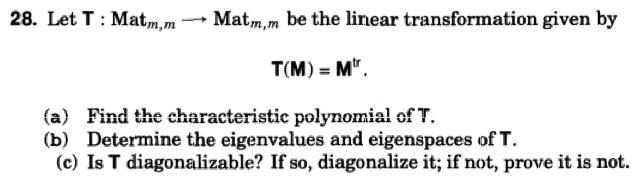

My instructor wants me to only solve for the case m=2.
So I thought I should discover what T does to the standard basis for matrices of size 2x2:
[itex]T \left| \begin{array}{cc}
1 &0 \\
0&0 \end{array} \right| = \left| \begin{array}{cc}
1 &0 \\
0&0 \end{array} \right|[/itex]
0 &1 \\
0&0 \end{array} \right| =\left| \begin{array}{cc}
0 &0 \\
1&0 \end{array} \right|[/itex]
0 &0 \\
1&0 \end{array} \right| =\left| \begin{array}{cc}
0 &1 \\
0 &0 \\
0&1 \end{array} \right| =\left| \begin{array}{cc}
0 &0 \\
0&1 \end{array} \right|[/itex]
At this point do I have to create a matrix consisting of these transformed matrices in order to find [itex]Δ_T (t) = det(M - tI)[/itex]? I'm kind of confused about my next step.
Yes, try to find the matrix of T with respect to your basis. This will be a 4x4 matrix.
But if the matrix is 4x4, how will I apply it to a 2x2 matrix? The inner matrix dimensions won't agree.
The 2x2-matrices won't have anything to do with the matrix of T.
The entries of the matrix of T are coordinates.
For example, if we put on [itex]M_{2,2}(\mathbb{R})[/itex] (the 2x2-matrices) the basis you mention, then the 4x4-matrix will contain the coordinates of the image of the basis.
For example, you have to write
[tex]T\left(\begin{array}{cc} 1 & 0\\ 0 & 0\end{array}\right) [/tex]
as a linear combination of the basis. So we have
[tex]T\left(\begin{array}{cc} 1 & 0\\ 0 & 0\end{array}\right) = 1 \left(\begin{array}{cc} 1 & 0\\ 0 & 0\end{array}\right) + 0\left(\begin{array}{cc} 0 & 1\\ 0 & 0\end{array}\right) + 0\left(\begin{array}{cc} 0 & 0\\ 1 & 0\end{array}\right) +0\left(\begin{array}{cc} 0 & 0\\ 0 & 1\end{array}\right)[/tex]
So the coordinates of
[tex]T\left(\begin{array}{cc} 1 & 0\\ 0 & 0\end{array}\right)[/tex]
are (1,0,0,0). This will be the first column of the 4x4-matrix.
Okay, then I have for my matrix:
[tex]
\left| \begin{array}{cccc}
1 &0&0&0 \\
0&0&1&0 \\
0&1&0&0 \\
0&0&0&1 \end{array} \right| = Q
[/tex]
[tex]
det(Q- tI) = det\left| \begin{array}{cccc}
1-t &0&0&0 \\
0&-t&1&0 \\
0&1&-t&0 \\
0&0&0&1-t \end{array} \right| = (1-t)(1-t)[(t)(t) - 1] = (t-1)^3 (t+1)
[/tex]
That is the characteristic polynomial, and its roots are the eigenvalues. So we have eigenvalues 1,-1. Look about right?
That sounds correct. Now you need to find the eigenspaces.
