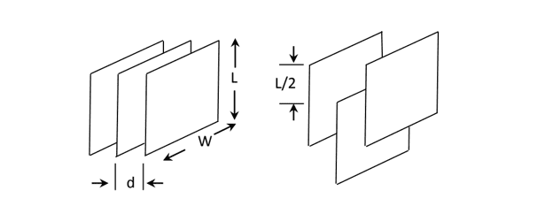

Energy ratio of two systems with charged planes
In summary: I really don't know if it's a correct analysis of the system, and even if it is I don't know how to proceed.
Eitan Levy
259
In those systems, the charge of the exterior planes is Q and the charge of the interior plane is is -2Q. Ignore side effects.
Find the ratio E(B)/E(A), where B is the system from the right.
E=σ/2ε[SUB]0[/SUB]
Honestly no idea how to get an answer. I found the electric field between the planes and out of it in those two cases but this didn't take me very far.
The final answer is E(B)/E(A)=2. Can someone please explain why?
Can you show some details for what you've done so far? What field values have you found for the exteriors (and how did you determine them)?
Please give the complete statement of the problem. Are the plates conductors?
It looks like you might be using the symbol E for both energy and electric field.

My apologies, the question is discussing the ratio of energies.

Conductors. I know it has been a while, but I still don't know how to get an answer to this problem.
1. I assume you know how to determine the E fields in system A.
System B:
realize you can split this into two independent subsystems. You can cut each plate into 2 equal plates of area LW/2 and physically separate the top 2 half-plates from the 3 lower half-plates. So you have two half-plates separated by 2d, and 3 half-plates each separated by d; each system of half-plates is lined up symmetrically. (A half-plate has area = LW/2). The two top plates have nothing to do with the bottom 3 except for the fact that the total charge on each full-plate is as given.
Now treat the two systems as totally isolated from each other and compute the various ## \sigma ## (surface charge densities) for each system.
Once you have all the sigmas you know the top & bottom electric fields ## E ##, then you can compute the two energies by ## U = 1/2~~D \cdot E, D = \epsilon_0 E ##..

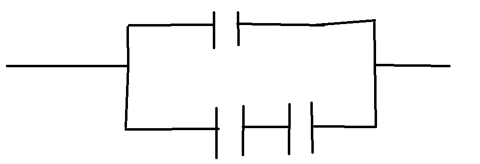

I am unable to calculate the densities.
I tried to look at the system like this:
I really don't know if it's a correct analysis of the system, and even if it is I don't know how to proceed. Are the charges on the second and third plates (looking at the lower sub-system) -2q? Are they -2q combined? Can I assume the that each pair has opposite densities? I really don't know.
I don't think looking at capacitor equivalents is a good way to go. Just my opinion. Capacitors usually have equal & opposite charge on their plates since they're charged or discharged by a current. But some folks make it work sometimes.
I prefer to assign ## \sigma ## to each surface. So for the top plates you have, left to right,## \sigma_1, _2, _3 ~and~_ 4. ## You can eliminate some of these; for example, what about ##\sigma_2## and ## \sigma _3##? And you know that ##\sigma_1+\sigma_2## must equal the charge on that half-plate. You also know that for a given plate, charge on top half-plate + charge on bottom half-plate must equal the given total charge. And so on. You need to play around with these concepts, get a system of equations to solve for all the ##\sigma##.

This is where I am getting confused at:
The electric field inside the conductors must be equal to 0. So if I take a Gauss pillbox between an outer plate and the middle plate (looking at the lower part), the densities there must cancel each other. That means that on the lower parts of the outer plates there is a charge of 2q. That leaves me with -q for the upper parts but it doesn't make sense because then taking the same pillbox the electric field inside the conductors will not be 0.
Why? The middle plate has a total charge of 2Q so half that charge, i.e. Q, could reside on each surface, in fact on the upper half of each surface if the lower half has zero charge; and so you'd get equal & opposite charge on each lower outer half-plate

Do you mean that on one side of the middle plate there would be charge -q and on the other -q again? The concept of sides when talking about planes is very confusing to me. How did you know the charge would split evenly between the two "sides"?
It should be obvious from symmetry considerations. How could it be otherwise?

Well, then I assume that for the outer plates the charge is entirely on the lower part. The only way I am able to understand this is by thinking about the upper part of the middle plates and the lower part of each outer plate to be capacitors. So if each side of the middle plate has the charge -q, the other parts of the capacitors (i.e. the lower parts of the outer plates) must have a charge q.
Please, how can you deduce otherwise that the charge on the lower outer plates is q? I would love to hear.
Right.
You should be aware that for an electrostatic field, flux lines begin at one polarity of charge and end at the other. By symmetry, charge on the upper half of the outer plates must have the same polarity. Which says what about the E field between the upper outer plates? E.g. using your pillboxes?
That reasoning is correct but it is unnecessary to think capacitors.

I am sorry but I don't understand. I really don't know at all how to analyze this.
If you are willing to do so please write how to analyze this probably. It will help me tremendously, I have already wasted hours on trying to understand this.
EDIT: Let me elaborate.
Let me elaborate.
If the charges are equal on the top parts then the total field there is 0. No energy is stored there.
Usually the field inside conductors is 0 because there is movement of electrons twhich cancel out the outer field.
Still, I don't know how to use these facts to analyze the system.
