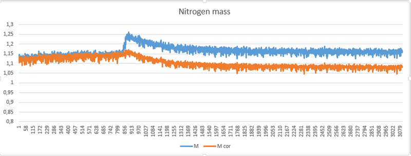

I have an rather large piston-cylinder containing gas that is compressed when the piston extends. Using three sensors I am measuring the pressure, temperature and volume of the gas while I force the piston out using a winch. The system is closed and no gas is released or added to the system while doing the experiments.
From the data collected I am calculating the gas-mass using the ideal gas law (PV=mRsT). I was expecting the gas-mass to be more or less constant, however the results show that the mass seems to change during the gas-compression phase, and slowly crawl back to the initially calculated mass from before the gas-compression phase was started.
I've attached the state variables that i logged during my experiment. I started with the piston fully retracted, then pulled it out using a winch and kept it there for the rest of the experiment.
Could someone, with a bit more brains than me, enlighten me as to why the mass is not constant, and maybe point me towards another approach to calculating the mass of the gas in the cylinder?
My own hunch tells me that it got something to do with the limitations of the ideal gas law, but my thermodynamics knowledge is not sufficient to fully understand it. :)
The mass is not changing. The real question is why does the measured pressure peak and then come back down again during the transient? Without knowing the details of the setup and the locations of the sensors, it's hard to say.
You are correct in saying that the ideal gas law is not appropriate for this situation, since the pressures are too high. You need to use the compressibility factor z (or other equation of state) to get a more accurate answer for the initial and final equilibrium states.

The setup is quite simple - I'm measuring the piston position and calculating the gas volume from known dimensions. The pressure and temperature sensors are mounted in such a way that they are both in contact with the gas.
Regarding the pressure:
I've been wondering about that myself. I'm guessing heat is added to the gas during the compression, but again that is somewhat weird since the temperature is more or less constant through the whole experiment. (Isothermal process). Could heat be added to the system without the temperature rising? The weird thing is that the pressure has that peak and comes back down again without the volume changing at all.
Regarding alternate EOS:
I've tried calculating the mass using cubic EOS as well - only difference is slightly more mass - but the transient behaviour is still not stable and behaves as when calculated with the ideal gas law.
Here's what I think is happening. I'm guessing there is something wrong with the temperature measurement. Here's why. The pressure increase at the peak seems to be consistent quantitatively with the increase one would calculate for adiabatic reversible compression for the imposed volume compression ratio. In adiabatic compression, the temperature of the gas rises. After the peak, I think what we are looking at is cooling back down to the cylinder temperature. If I am right, there should have been about a 15 degree temperature rise during the compression, followed by subsequent cooling.

Calculating the temperature based on the compression ratio, adiabatic, leaves me at the same conclusion as you. There must be an issue with the temperature sensor as expected temperature should be around 40 deg. C.
[itex]T_2=T_1(V_1/V_2)^(\gamma-1)[/itex]
With T_1 = 18.6 C and V1 = 0.0176, V2 = 0.015 and [itex]\gamma[/itex] = 1.4. I get T2 = around 38 C or 311 K.
Using the theoretical temperature, I get a smoother curve for the mass. I'm guessing that the initial temperature is somewhat wrong as well - causing the theoretical temperature to start out a bit wrong as well.

I would only apply this equation to getting the peak temperature. After the peak, the gas is almost certainly cooling, and you have no idea how the temperature is varying with time.
Please don't say that the mass is varying. The experimental data give no justification for making this assumption. In fact, they seem to indicate that the mass did not vary (comparing the initial and final states).

From time t = 900 on, try using the relationship T = 291+20exp(-(t-900)/300) for the temperature, and see what you get for the predicted mass.
Chet
Hi Ida. Welcome to the board. The compressibility factor of nitrogen at the highest pressure (~ 68 barg) and a temperature of ~ 18 C is 0.994 and at the lowest pressure and temperature you show is around 0.993 so the variation from ideal gas is less than 1% and the difference you would calculate between the two states based on the variation between ideal gas equation and actual is only 0.1%. So the problem isn't with using the proper equation of state. The issue seems to be as pointed out, the temperature measurement is not capturing the bulk temperature of the gas.
I suspect the temperature probe may be closely following the vessel wall itself, not the gas inside. If you have a temperature probe on the vessel wall, and I assume this is steel or metal of some sort and relatively thick because of the pressure involved, then that metal has a tremenous amount of thermal mass. The amount of energy being put into the gas is small compared to the thermal mass of the vessel. To obtain a proper temperature reading of the gas is not easy because it will vary considerably from some location close to the vessel wall to some location in the center, furthest from the wall.
There is another problem though. From the trace of the pressure graph, you can make some inference of the temperature. Long after the pressure is changed, the pressure trace seems to level out indicating the temperature should be coming close to equilibrium. But even after that happens, there still seems to be some residual difference between the mass before and after the pressure change. There could be a very small error with the measurement of pressure or volume. Of course, you're only looking for an error between 1.13 kg before compression to 1.15 kg after compression or around 1.8% error. You won't find that much error in the calculation because of the assumption regarding an ideal gas. This small amount of error that appears after the system comes to thermal equilibrium appears to be caused by something else. Perhaps volume or pressure measurement. Regardless, the variation of less than 2% is relatively small.
I had to change the initial conditions and the delta temperature in the heat transfer equation to make them fit the dataset I have. :)
Looks like you are indeed very correct in your assumptions that the temperature is the culprit. Using your heat transfer model, the calculated mass looks very stable.

You are absolutly right regarding the temperature probe - it is indeed screwed into the top of the cylinder, surrounded by very thick metal walls. From the looks of it I need a more appropriate sensor for measuring these temperature variations. The PT100 I'm using now has a slow risetime (4-8s), and is also in contact with both the metal walls and the gas obviously, thanks to you guys, gives me totally useless data for the task I'm trying to achieve.
Regarding the initial vs. final mass:
I was doing several of these experiments, and I think that the issue here is once again the temperature. I removed the tension from the winch right before this experiment, letting the piston move into the cylinder again, and thus expanding the gas volume and ultimatly cooling the gas. I'm guessing I did not wait long enough, so the temperature was still going upwards while I started this experiment.
