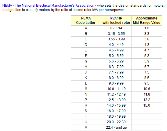

If you're going to have trouble it'll be at starting.
See if your pump motor has on its nameplate an entry LRA (for Locked Rotor Amps) or KVA CODE (a clue to starting current)
LRA is what the motor draws when starting .
KVA code is how many KVA it draws when starting, they give it in KVA per hp
http://www.engineeringtoolbox.com/locked-rotor-code-d_917.html
example: your 2hp motor, if it's a code F would draw about 5.3 X 2 = 10.6 kva when starting.
Amps = KVA/KV, so at 230volts(0.23KV) that'd be 10.6 / 0.23 = 48 amps.You don't have to meet that 5% voltage criterion during start because the pump is easy to turn until it begins lifting water.
Instructions I've read say if you make 5% running at full load you'll be okay .
That's why you need to listen to it - does it accelerate smoothly up to full speed ? If it labors in that last little bit of startup , well you're approaching the limit.
That's the logic behind your testing.
