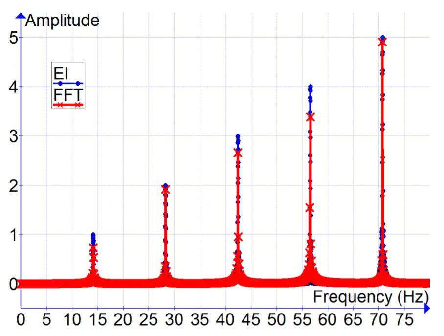

Part of the issue is that you are dealing with a function that is heavy with high-frequency components. What the FFT is really operating on is a periodic function - one that has a pulse every N ##\Delta##'s.
I never trust the transfer function of an FFT as it is dependent on the algorithm and the size of the data set. Also the gain of the DC = Cos( zero ) term can often be different to AC terms.
The only way to be sure is to Slowly-Fourier-Synthesis a known amplitude sinewave, at an integer frequency, then FFT to identify the transform gain. Also check the DC gain.
Obviously different window functions change the gain by scaling the data, but they also convolute energy into adjacent bins which confuses the transfer function for real data with non-integer frequencies.
Most applications of the FFT can ignore the amplitude scale factor, and save time.
Yes. The windowing function is what you normally apply to your FFT output to avoid the problem with ambiguous high frequencies. It is usually 1 for most values and tails off to about zero at the ends of the FFT array. For the delta function, the windowing function is problematic.
Well not quite, you have it backwards. The window function is applied to the input before the FFT. It does two things. Firstly, it eliminates the sudden step where the extreme ends of the cycle meet, so it removes the inherent high-frequency step noise from the spectrum. Secondly, it convolutes the input signal, which is widened so it falls into two or more bins, and not into the deep null between two bins where it could disappear completely.
Frequency analysis involves multiplying the input signal by all possible waves to detect by correlation. The FFT is therefore a harmonic mixer, so an anti-aliasing filter is needed to remove all frequency components above half the sampling frequency. That is done before the window is applied, to eliminate the harmonics of valid signals from being folded back around the spectrum as aliases.

Great detailed response, except I'm pretty sure Shannon and Nyquist would disagree with you about this:
Baluncore said:
...not into the deep null between two bins where it could disappear completely.
Without windowing, a signal at a frequency between two bins doesn't vanish ar all; it is spread out over a larger number of bins; the window reduces the spreading,
This is not true. That’s like getting more information than is available from your data.
Think about applying a rectangle function that truncates your data. Or think about the Heisenberg uncertainty principle. If you apply a window to localize your data, the alternate domain must spread out.
The purpose of this window functions is apodization. Getting rid of the “feet” around peaks and cleaning up the noise from aliasing so to our eyes we can better visualize the data. I think this is what you meant to convey.
OK, so the energy cannot completely disappear, the energy is redistributed in the spectrum. Like a tube of toothpaste, if you squeeze it at one end, it will come out somewhere else.
An input frequency midway between two bins implies a maximum step at the ends of the cycle, so windowing lowers the noise floor by removing that step, which in a sense is a reduction or a narrowing of the spectrum.
At the same time, multiplication by the window function in the time domain, is convolution in the frequency domain. As the time domain windows used are fundamentally a single cycle, the convolution adds one bin to either side of the response peak. So window convolution widens the response, usually from two bins to four or more bins. Just what the window does is determined by the spectrum of the time domain window selected and the exact frequency of the signal, but it effectively spreads or partitions available energy into adjacent bins that were once skirt.
So windowing does two opposite things, it reduces the broadband noise floor, while at the same time it widens and lowers the peak of the response, both of which smooth the spectrum. Because the local spreading of energy reduces the peak value detected, depending on application, it may require the transform gain be recalibrated.
There are too many places to squeeze the toothpaste tube. There is the top of the peak, the skirts, or the high frequency noise floor.
You can usually find a window function that will convolve the input energy into any spectrum you might want as an output. You cannot be truly good, unless you have bad thoughts, and can resist them.
Apodization can't fix aliasing. It's used to reduce sidelobe levels, which can lead to a host of ills when performing spectral analysis including: "straddle loss," energy leakage into neighboring bins (sometimes referred to as the "Picket Fence" distortion), and the masking of weak spectral lines by spillover from nearby strong ones.
The downsides of windowing are: broadening of the main peak (someone correctly mentioned energy conservation--energy from the sidelobes ends up in the main peak), arbitrary deprecation of signal content at the beginning and end of the data record, and the lack of any rigorous basis (it's an ad-hoc band aid, which is one reason that dozens of different windows have been invented and used).

I should also mention that my students and I use some variations on this theme as means to validate any Fourier transform code we use. (Trust but verify when it comes to computer programs.) We input a short series of sine and/or cosine terms with known frequencies, amplitudes, and phases and check the results against the expectations. We also commonly add various amounts of Gaussian noise to see how the code response to known signal and known (but variable) amounts of noise. Not all Fourier transform codes are equal when it comes to recovering the signal from the noise. All the coding tricks and analytical variations are best studied when one knows a priori what the signal looks like. This gives a much better idea what may be happening when one does not know a priori what the signal looks like.
For example, the figure below compares Fourier transforms of a series of 5 cosine terms with frequencies of 10, 20, 30, 40, and 50 times sqrt(2) and amplitudes of 1, 2, 3, 4, and 5, respectively. Note that the EI (explicit integration) technique yields the expected amplitudes accurately, but that the amplitudes from the FFT method are systematically low. The reasons for this are well understood and explained in the paper from which the figure is taken. (https://arxiv.org/pdf/1507.01832.pdf ). A fact that is often neglected (and not mentioned in the paper) is that changing the window function applied to the data will also change the size of the Fourier transform amplitudes. When a window function is applied to time series data prior to computing a Fourier transform, the scale factor needs to be changed if one wants to recover accurate amplitudes.
