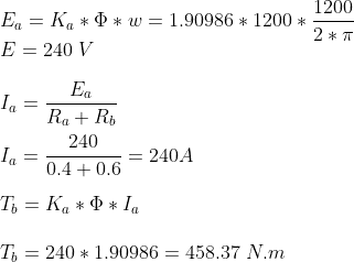

A 300 V DC separately excited motor has the parameters Ra= 0.409, C= 1.90986 V rad/s The motor drives a constant load torque of value 286.479 Nm at speed = 1200 rpm
Part 1: If the motor needs to be braked using dynamic braking and that is by using a braking resistance of value Rb=0.6
a) The braking torque at the instant of braking
b) The braking torque when the machine speed has decreased to 800 rpm
c) The braking torque when the machine speed becomes zero.
Here's my attempt for part 1a:
What I am not sure about is the direction, is it in the opposite direction (= - 458.37 N.m ) or it's positive?

As Tom already said, in a dynamic braking process, we have to disconnect the source of the armature and turn the motor into a generator producing current through Ra and Rb. The generator is consuming the kinetic energy accumulated. That means from 1200 rpm up to 0 the torque is negative [opposite to the motor torque].
If the rotor it is in a still stand position -that means rpm=0-no Emf is producing then dynamic braking it is not possible. The start current is high Istart=Vsource/Ra and the motor torque is elevated but you have to find another way-not dynamic braking-to brake it.
p.s. by the way the Ea formula has to be Ea=C*2*π*rpm/60=240:wink:

I asked him about the direction of the torque during braking, is it always negative? He said "Yes".
Thanks for your reply.
Could you please tell me what is the difference between them? because sometimes we use C if it's given, and mostly use Ka * Phi.
If we calculate the mechanical- shaft- power Pm=Tq.2.π.rpm/60=36000 W [36 kW] and add the copper losses as Ra.Ia^2[Ia=150 A] -neglecting other losses [friction, ventilation, magnetic and other] we get Pinput=45000 W [divided by 300 V we get 150A].C=Tq/Ia C=286.479/150=1.90986. Then C=Ka. Φ
