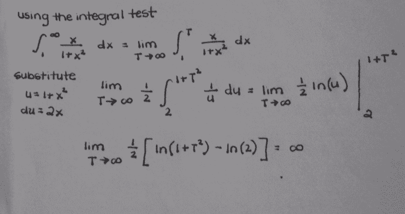

Okay this is what I did. I decided not to use the ratio test anymore.
http://img341.imageshack.us/img341/5567/calculus.png
What you have done is pointless. Noting that the nth term of a series goes to zero tells you nothing about convergence of the series.

OK. Well I have already told you the ratio test won't work and you see it isn't an alternating series. It isn't a p series. So that leaves comparison and general comparison test and integral test. So try something.
Okay, I tried the integral test. Does that answer look better now?
Therefore, the seires is divergent by the integral test.
Looks fine.
The integral test works nicely. Though what I'd do is the Ratio Test. Nice solution! Really, really nice.
Which, as I have mentioned before, would be inconclusive.
Yes. See, all you had to do was try it. Good writeup.
