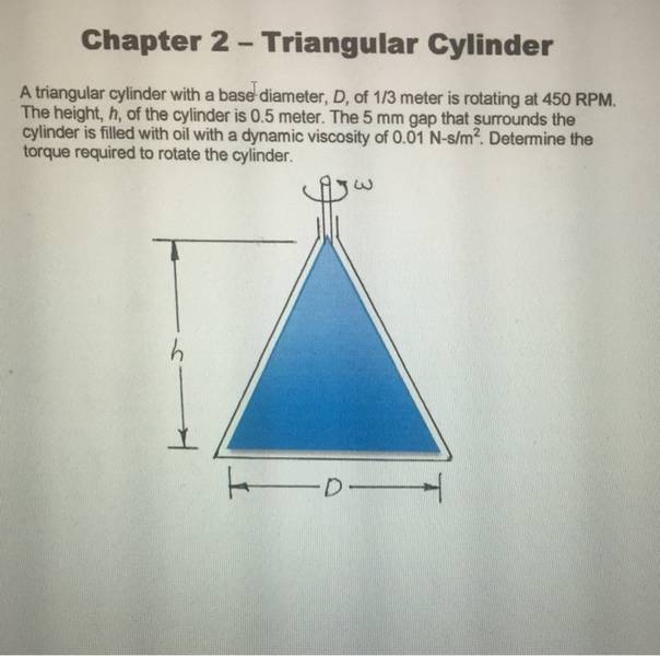

τ= η* (dv/dy)
so
dA= 2π* r * dr
T = ∫ τ * r * dA
T = ∫((0.01* r* 2*π * 450 /60)/(5*10^-3) ) * r * 2π* r *dr
= (592.1762)*(r^4/4)
T = 0.11 Nm
is this correct?
