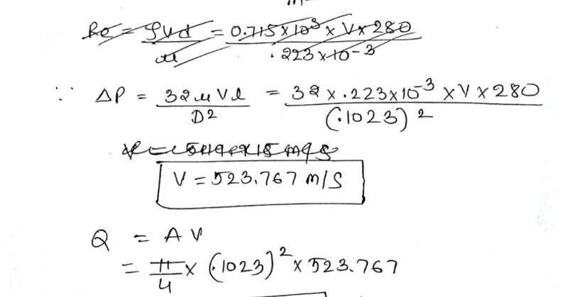

[/B]
- The pressure drop equation. [/B]

P=32 x w x Vavg x L / D^2
You seem to be assuming you have laminar flow, when the problem statement strongly hints that the flow is turbulent. Have you calculated a Reynolds number?
Yes. I’ve got my Reynolds number, but that’s where I’m confused at. I just don’t know where to go from there.
Are you familiar with how to get the pressure drop in pipe flow using friction factor and Reynolds number?
Where did you get that value for the diameter from?
Do you really think that a flow velocity of 524 m/s is realistic?
I’m not to sure how to find the pressure drop with the friction factor. I’m not familiar with that equation.
