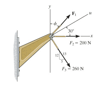

In summary, Homework Equations state that:-Fx=200+cos(67.38)260+cos(59)-Fy=-sin(67.38)260+sin(59)To find the magnitude, F1x,y must be solved for. F1x=-384.06 and F1y=279.99. The resultant force acting on the bracket is required to be a minimum, and is found to be 479.335N.

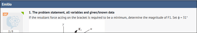

If the resultant force acting on the bracket is required to be a minimum, determine the magnitude of F1. Set Φ=31°
Fx=F(cos(θ))
Fy=F(sin(θ))
First I tried to find ∑Fx and ∑Fy
ΣFx=0=200+cos(67.38)260+cos(59)F1x
ΣFy=0=sin(67.38)260+sin(59)F1y
Solving for F1, I got
x=-384.06
y=279.99
And then to find the magnitude, I found the root of the sum of their squares
√(-384.06² + 279.99²)=479.335N
which was wrong.
A few things: I know the x-component can't be negative, it makes no sense, but I don't know what to change to make it positive. I also don't know what is implied by "required to be a minimum."

Your mistake is in equating the sum of the components to zero. That would certainly be ideal, but with the angle fixed all you can aim for is a minimum, not zero.
What does it mean to find a minimum? A minimum force that would keep it in equilibrium? The smallest possible resultant force?
The resultant sum of those 3 external forces is to be its smallest possible value.
So instead of ∑Fx,y being equal to 0, they should equal the smallest possible value?
Wouldn't that be Fx=0 and Fy=0?
The character set you are using seems problematical. I saw Fy= -∞ in your post, which seemed a puzzling value; yet when I quote that to respond, that -∞ has transformed into a 0. You should be using the characters that appear when you tap ##\Sigma## in the forum editor toolbar, or else use Latex.
You can't make the resultant horizontal force equal to zero, as all forces have a component to the right---there is not going to be any cancelling in the x-direction.
I had typed -∞ at first, but after considering it, I realized it didn't make sense so I changed it to 0.
So I can't set Fx=0, but I want to get this value as small as possible. Do I set up a limit as Fx approaches 0?
Probably not.
You had the right idea back in your opening post:
So go back to your first post, and improve on that. If force up is +, then downwards will be -
That won't be F1x, it's just F1 because the cos converts it to the horizontal component.
