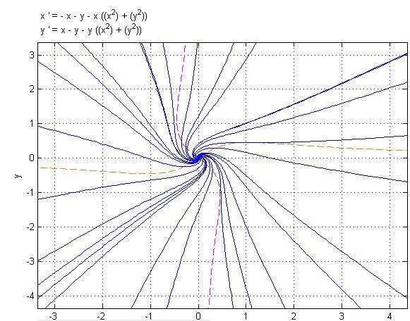

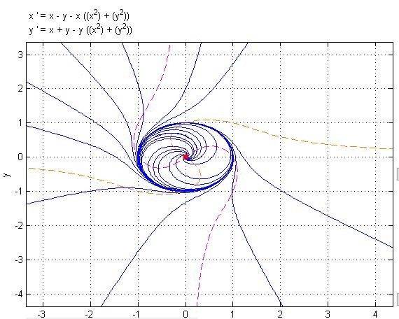

So what does this tell us about the system and in particular about our Poincare map, especially at $(0,0)$.
I will include the graph with some periodic orbits around the origin to show;
if $\mu < 0 \implies (0,0) =$ Spiral sink
if $\mu > 0 \implies (0,0) =$ Spiral Source
Can you guess which phase portrait corresponded to the hypothesis above?
