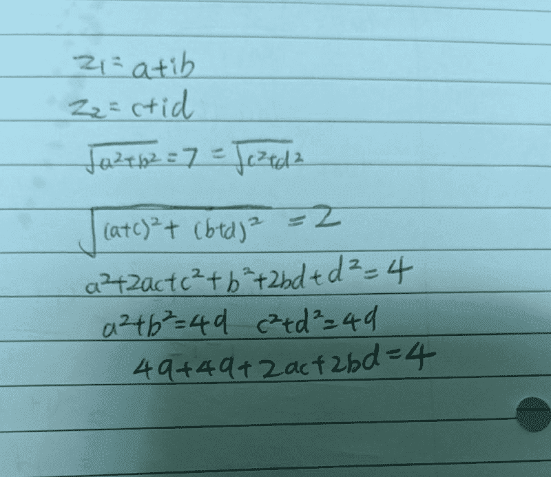

5)
Let ∣z1∣=∣z2∣=7∣z1∣=∣z2∣=7
If ∣z1+z2∣=2∣z1+z2∣=2,solve ∣1/z1+1/z2∣
How do I even proceed from here?

for 5, instead of doing it the hard way (by replacing ##z_1=a+bi, z_2=c+di## e.t.c) use properties of the modulus and algebra in the set of complex numbers. Properties of modulus are pretty much like the properties of absolute value in real numbers and algebra in C is pretty much the same as algebra in R so for example
##\frac{1}{z_1}+\frac{1}{z_2}=\frac{z_1+z_2}{z_1z_2}##
Likes PeroK
So for question 5, answer will be 2/49?
Thanks for the tip :)
Yes that's correct.
