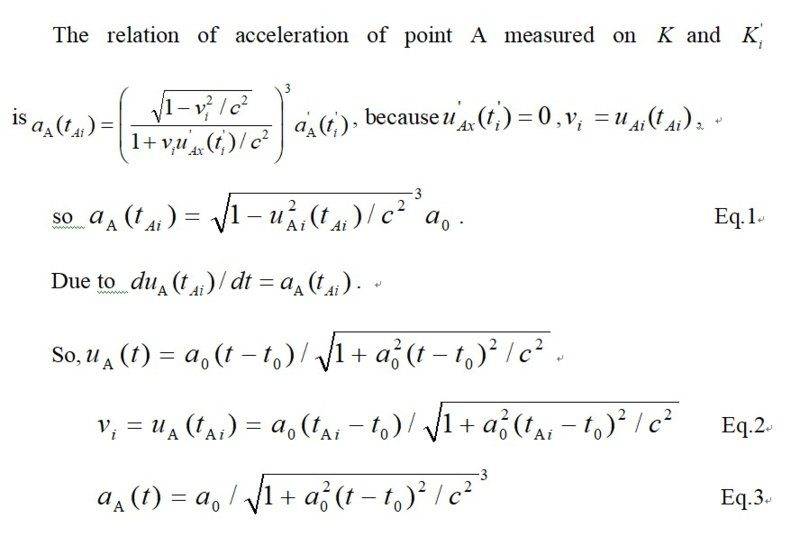

Assume a particle (A) is rest on the inertial coordinate system ##K## before time ##t_0##. At time ##t_0##the particle began to accelerate along x-axis (no rotation). For any ##{K_i}’##, at time ##{t_i}’## when the particle is rest relative to ##{K_i}’##, assume the acceleration of the particle is ##{a_A}’ ({t_i}’)=a_0## (a constant not change over ##{t_i}’##) measured on ##{K_i}’##.
It's too tired to change the formula to latex these days, so use a picture.
