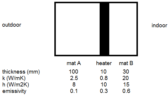

Studying for a test, and this problem stumped me because of the confusing nature of the question... Not sure where radiation shld come into play. Any help appreciated! THANKS!
1. Homework Statement
The walls of an apartment are made of two layers of mat with a heater layer in between.
Thickness, thermal conductivity, emissivity of each surface and convective heat transfer coefficient in still air are given above.
The outdoor temperature is at -10oC, and the indoor temperature is controlled by the heater layer.
Assume the apartment has 4 side walls, each 10m wide and 3m high, and heat loss through ceiling and ground are ignored.
Also assume inner surface of the wall (facing indoor) are perfectly insulated, but do not assume convection and radiation at outer surface is negligible.

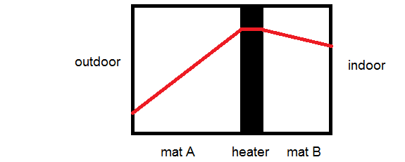

(a) Sketch the (steady-state) temperature profile across the wall, from the outer surface to the inner surface.
(b) The heater is generating heat at 250W/m2. What is the steady state temperature of the Mat B layer? To estimate the radiation heat transfer coefficient at the outer surface of the wall, assume temperature at surface of Mat A is close to -10oC.

(a) Assume temperature within heater layer is constant (can I do so?),
I drew them linear because without heat generation, the profile is linear. The slope in mat A is also steeper due to the k/L ratio compared to mat B. (Is this alright?)

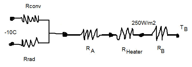

(b) So to solve this, I drew a thermal circuit. However I'm not sure where to place the radiation resistance. Please help me verify if I drew this correctly.

Here are my thoughts on this:
1. The temperature within B is constant, since the inner wall is insulated.
2. The temperature within the heater layer is not constant. It is highest at the side toward B and decreases monotonically toward A, but not linearly.
3. There reason they say that the outside surface is close to -10 is so that you can linearize the equation for the radiative heat transfer. So there actually is radiation and convection at the outer surface.
4. Your diagram of the resistances is basically correct.
Chet

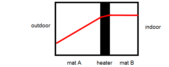

I might be wrong but...
There appears to be no mechanism for heat to be lost from the room - no ventilation and the loss from floor and ceiling is to be ignored? If that's correct the room side of the heater mat cannot be hotter than the room. If it was heat would flow into the room and raise the temperature. Likewise if the room side of the heater is colder than the room heat will flow out of the room and the temperature will fall.
So I would argue that the room side of the heater mat must be at room temperature. So the temperature in B will be constant. I think you can forget about Rb. All the heat generated by the matt must flow outwards once the temperatures are stable.
So I'm thinking it must be something like this (although Chester points out it wouldn't fall in a linear manner in the heating mat).

Yes. That's what I was getting at when I said that "The temperature within B is constant."
Chet
