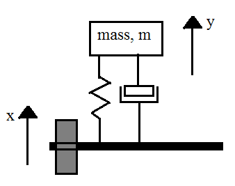

Diagram for a vehicle suspension is given. Displacement of wheel is given by 'x' and and displacement of body is 'y'.
Spring constant, k = (7*10^4) Nm
Damping coefficient, c = (3*10^3) N/m/s
mass,m = 250kg
a) Make a Laplace Transform of system and utilize it to predict 'y' in response to various inputs (step, impulse, ramp)

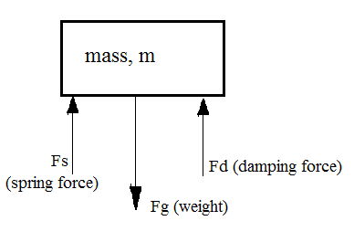

∑F = ma (but at equillibrium, a = 0)
Therefore ∑F = 0
(ignoring force by damper for now and resolving forces)
Fs = mg
Fs = k[ (original spring length, L0) - (new spring length, X0) ] = mg
Fs = k[ L0 - ( X0 + y(t) - x(t) ) ]
After simplifying...
Fs = k( L0 - X0 ) - k( y(t) -x(t) )
∑F = -mg + k( L0 - X0 ) - k( y(t) -x(t) )
Because mg = k( L0 - X0 ) [proven above]
∑F = - k( y(t) -x(t) ) = ma

Accounting for the damping force
Fd = -c[ (dy/dt) - (dx/dt) ]
Therefore
∑F = - k( y(t) -x(t) ) - c[ (dy/dt) - (dx/dt) ] = m(d^2y/dt^2)
m(d^2y/dt^2) + c(dy/dt) + ky(t) = kx(t) + c(dx/dt) <---- Differential equation
Applying Laplace transformation...
Y(s)ms^2 + Y(S)cs + Y(S)k = X(S)k + X(s)cs
Y(S)[ms^2 + cs + k] = X(S)[k + cs]
Therefore,
Y(S)/X(S) = (cs + k) / (ms^2 + cs + k)
I have completed the question up to that point. It would be appreciated if someone could check my working and let me know if my answers are correct or there is something wrong.
I'm also having trouble completing this part of the question:
"it to predict 'y' in response to various inputs (step, impulse, ramp)"
Am I correct in assuming, this is how you do it?
Y(S) = [ (cs + k) / (ms^2 + cs + k) ] * X(S)
(cross multiply X(S))
And then you substitute values for X(S).
Ex:
unit step, X(S) = 1/s
ramp, X(S) = 1/s^2
Is that how its done?
Any and all advice will be much appreciated. Thank you
AnkleBreaker said:
Ex:
You should write: X(s) = 1/s, because what is (upper case) S?
Another thing is: Is it physically possible to change the displacement of the wheel, X(s), by a stepfunction? What will the velocity, s*X(s), or the forces be at that instance ?
A ramp or a sine wave is ok.
I have not checked your work, but in principle it seems to be correct.

Hesch said:
Instead of calculating in the time domain, why don't you sketch the system directly in the Laplace domain ( see attached ).
Thank you very much for your reply.
I looked at the attached pdf. I calculated in the time domain, because in the second part of the question, we have to create a simulink model, for which I thought I would need the differential equation.
Your attached document has a final Laplace model similar to the equation I got. Do you think my working is correct?
Thank you for your reply
AnkleBreaker said:
I was under the impression that once laplace transform is applied, (lower case) t is converted to (upper case) S
You may choose 'S' or 's': X(S) = 1/S or X(s) = 1/s. Both makes sense.
But writing X(S) = 1/s doesn't, because the righthand side is not a function of S, but a function of s, which is the complex variable in the Laplace domain.
Yes.

I'm partway through finding the responses. Just to clarify, all I have to do is substitute X(s) by 1/s (unit step), 1 (impulse), 1/s^2, and then simplify and then find the inverse laplace (to convert it back into a time domain). Am I correct?
Thank you for your response.
