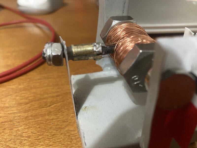

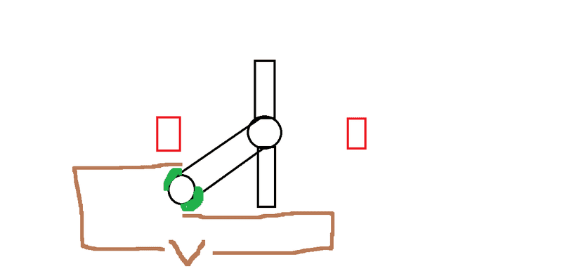

Yup @S_Noakes your drawing of the commutator shows it's wrong. as it turns and reaches the horizontal magnets the metal plates are still connected , so now your motor becomes an electromagnet , the poles just stick to the magnets and stay there because the current doesn't end ,
well it might end on a second thought but that depends on the speed of the rotor , if the plates are too close , they might short circuit the wires.
Likes berkeman and S_Noakes
  • #37
artis said:
Yup @S_Noakes your drawing of the commutator shows it's wrong. as it turns and reaches the horizontal magnets the metal plates are still connected , so now your motor becomes and electromagnet , the poles just stick to the magnets and stay there because the current doesn't end , is not switched off at that moment.
Do you see your own mistake ?
Yes, I do. Thanks. That explains what my motor has been doing. I'll make the changes. Thanks for walking me through that.
Likes berkeman
  • #38
@S_Noakes on a second thought you don;t have to completely redo the whole thing, you can leave it almot as in your drawing but make the plates shorter at first , so there is more gap of insulation and the wires don't arc through.
Also position them such that the moment the rotor pole reaches exactly at the stator magnet the current is switched off , then a little bit of dead time/ insulation and only then the current switches on again to pull the rotor further.
The moment the rotor pole reaches the stator magnet is crucial because if the current stays ON for even a bit longer then it drags the rotor back and this is like "one step forward, half step back" kind of situation.

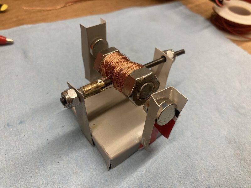

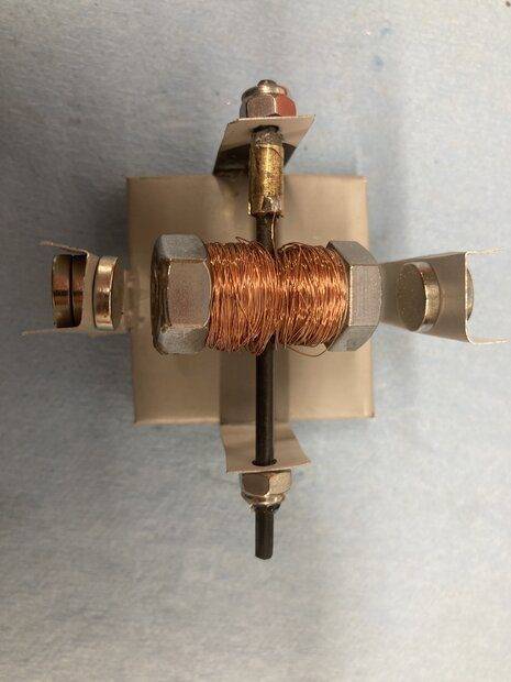

Switching polarity through the contacts has no discernible effect. The magnets will vibrate slightly and the motor will get hot. That’s it.
At one point you mentioned a 9V battery. You also mentioned using a wal-wart. Vibration indicates you are using an AC source.
  • #49
When not rotating, the armature gets hot because the current is limited only by the wire resistance and supply source resistance. When rotating, the current and therefore the magnetic field through the armature is alternated by the commutator, so armature inductance then limits the current.
The magnetic iron core is needed to increase the inductance of the rotating armature.
You will need a better armature, or better bearings and a lower voltage.

Here are the details. I started with a nut and bolt, and drilled a hole down the center of it. I inverted and glued into place a carbon fiber rod in the hole. I glued a bit on the end of the bolt. I wrapped magnet wire around the bolt on each side of the rod 400 times. I made a commutator using brass, and soldered one end of the wire to each side. The separation in the commutator is lined up the the bolt head and nut.
For magnets, I am using two small (but strong) magnets per side.
For power, I am using a 9-volt battery with copper wires connected to it. I’m touching the copper wires against the commutator 180 degrees apart.
The structure is made out of aluminum, if that matters.
What am I doing wrong? Am I missing anything obvious?
let me know if you want more info or pictures.
View attachment 291166View attachment 291167

I don't see any brush contacts. You haven't finished it yet.
