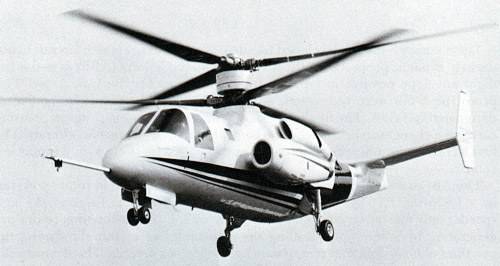

Some very cool "helicopters" are the http://en.wikipedia.org/wiki/Fairey_FB-1_Gyrodyne" . They are very cool mixing of tip-powered rotor technology and autogyro technology.
