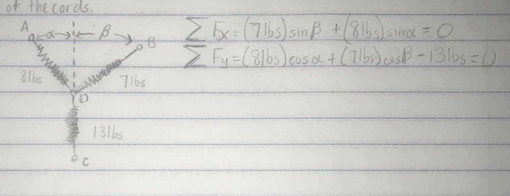

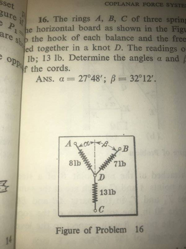

The rings A, B, C of three spring-balances are fixed to the horizontal board as shown in the Figure. A cord is attached to the hook of each balance and the free ends of the cords are tied together in a knot D. The readings of the balances are 8lbs; 7lbs, 13lbs. Determine the angles ##\alpha## and ##\beta## between the directions of the cords.
Ans. ##\alpha## = 27 ##^{{\circ}}##48’
##\beta##=32##^{{\circ}}##12’
$$\sum \vec{F}=m\vec{a}$$
Here is the diagram:
I’ve only drawn the diagram and made equations for the sum of forces in the x-directions and y-directions:
##\sum F_{x}=(7 lbs)sin\beta+(8 lbs)sin\alpha=0##
##\sum F_{y}=(8 lbs)cos\alpha+(7 lbs)cos\beta-13 lbs=0##

If you solve for one of the sines in the first equation, would you be able to use ##\cos x=\sqrt{1-\sin^2x}##?

$$7\sin\beta+8\sin\alpha=0\Leftrightarrow\sin\beta=-\frac 87\sin\alpha\\\cos\beta=\sqrt{1-\sin^2\beta}$$

You have ##\sin{\beta} = \frac{-8\sin{\alpha}}{7} \implies \cos{\beta} = \sqrt{1-\sin^2{\beta}} = \sqrt{1-\frac{64\sin^2{\alpha}}{49}}##. Now you can substitute ##\cos{\beta}## back into the second equation which gives you $$7\sqrt{1-\frac{64\sin^2{\alpha}}{49}} = 13 - 8\cos{\alpha}$$ Then you're in a position to square both sides and solve for ##\alpha##. You'll need to use ##\cos^{2}{\alpha} = 1-\sin^{2}{\alpha}##.

We square both sides of $$7\sqrt{1-\frac{64\sin^2{\alpha}}{49}} = 13 - 8\cos{\alpha}$$ to obtain $$49\left(1-\frac{64\sin^2{\alpha}}{49} \right) = 49 - 64\sin^2{\alpha} =169 - 208\cos{\alpha} + 64\cos^2{\alpha}$$ Now we substitute ##\sin^{2}{\alpha}## for ##(1-\cos^{2}{\alpha})##, $$49 - 64(1-\cos^{2}{\alpha}) =169 - 208\cos{\alpha} + 64\cos^2{\alpha}$$ Hopefully you can see that the ##64\cos^{2}{\alpha}## cancels on both sides. If you simplify that you can then get ##\cos{\alpha}##

Ah. Yes the general strategy here was to try and obtain some equation only in one of ##\sin{\alpha}##, ##\sin{\beta}##, ##\cos{\alpha}## or ##\cos{\beta}##, because then in the worst case you can do a substitution and you get a polynomial and in the best case (like here) you don't get any higher order terms and the answer comes straight out.

Thanks a lot for your patience, I finally got the answer.
