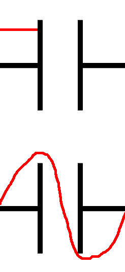

Hello everyone, I apologize if I revived an old thread.
I read all above posts and I understand why capacitors do not allow DC current. However, I suspect if there is any difference if the capacitors are connected in parallel. Do they allow DC current and block AC current in this case?
Thank you.

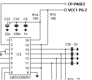

makes no difference, there is still a hole (gap) in the circuit that DC cannot cross
and AC will still flow in a circuit with multiple parallel capacitors

If AC didnt flow in a circuit with multiple capacitors in parallel then we would have a huge problem trying to smooth DC lines of power supplies either in a power supply itself or on a power rail in something like a radio transmitter, where we use different value capacitors in parallel to deal with AC signals of varying frequencies. Here is an example from a synthesiser I have ...
note the very different values of C9, 10 and C23 off the VCC1 rail
cheers
Dave

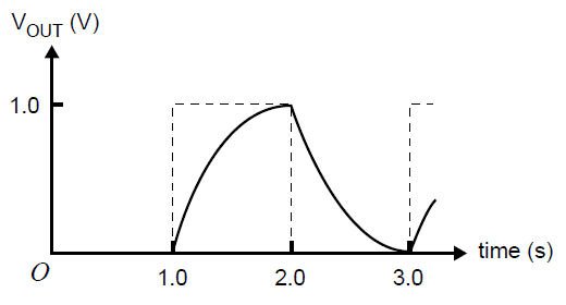

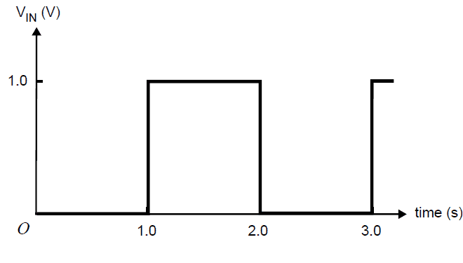

Also, If I have an input voltage like this:
I think this is a DC current, right? Since it only has positive values of V.
Normally, the capacitor will block the DC current. However, in this case, I think because the DC signal varies with time, so when the voltage is 0, it will give time for the capacitor to discharge. So, the graph for the capacitor will look like:
Please correct me if I am wrong at this point. Thank you!

LovePhys said:
Yes, thank you very much Dave! You cleared the point. My teacher said that the capacitors blocked the DC current if they were connect in series, but if they were in parallel, they allowed the DC current. But I do not agree with him. (By the way, I do not really understand your circuit. I am in year 11, so it seems to be beyond my level).
thats ok you are doing great for 11 yo :) yes its just a small part of a complex circuit. The main thing I wanted to show you was the 3 capacitors that were in parallel ( C9,10 and 23) and how their values were quite different. This allows for filtering of frequencies across a wide range.
the top image is not a steady DC voltage, as you can see its changing from 0V to 1 V
it is what is called a square wave. It is 1 second bursts of a DC voltage. You will mainly see square waves in digital circuits like computers etc. If it was a plain DC voltage then it wouldn't be varying from that 1V level with time.
Yes the lower diagram shows how the voltage across the capacitor would vary with a square wave applied

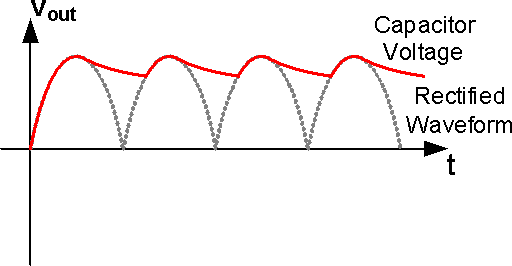

I just have one more question: Does the same thing happen to half-wave rectifiers with smoothing capacitors? I think that things will happen in this order: AC current (sine wave) => (diode) => varying DC current (positive voltages only) => Capacitor charges then discharges (this process is repeated several times). So in this case, we still have capacitors that conduct varying DC current.
And if we have a smoothing capacitor in a half-wave rectifier (in the picture below). Does the red "line" (I mean the part that is going down when the capacitor is discharging) a curve or a straight line? I was told by my teacher that it was a curve (just like the graph of a discharging capacitor), but it seems to be a straight line to me!?

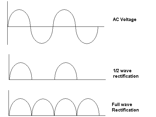

now that pic shows a full wave rectifier. You can see how the capacitor voltage 'sags' drops between the pulses of voltage from the rectifiers, but it keeps the overall voltage at a higher level and smoother than if it wasnt connected across the rectifier output.
have a look at these pics...
the top image is the AC Voltage
the middle image is a 1/2 wave rectified AC Voltage it only uses 1 diode. See the big gaps where the other half of the AC sine wave isn't being rectified.
the lower image is a full wave rectified AC Voltage
All of these are without a capacitor.
adding a capacitor to the output of the full wave rectifier gives the waveform shown as the red wavey line in your image. The difference in the Voltage between the lowest part of that red line and the top of it is what we call the "Ripple Voltage".
In a power supply we aim to get the ripple voltage as low (small) as possible. It would depend on the requirements of the power supply but a value of less than 100mV (milliVolts) would be good.

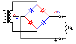

below are images of a half wave and a full wave rectifier...
half wave = just one diode
Full wave = 2 diodes
and this last image is a full wave of 4 diodes commonly known as a Bridge Rectifier

I found this equation on the hyperphysics: [itex] V_{C}=V_{0}e^{-t/RC} [/itex]. This equation proves that the graph of a discharging capacitor will be an exponential curve. I still don't know why the red discharging lines of the full-wave rectifier with smoothing capacitor still look like a straight line (even in my textbook, I have the same feeling that they are straight lines)!?
the image showing the red line is ok. It gives you a really good indication of what is happening in the rectifier circuit with a capacitor. If the capacitor is too lower value then the voltage will sag lower before the capacitor recharges with the next peak.
If the capacitor value is increased, then the voltage drop across the capacitor won't be so much between peaks.
