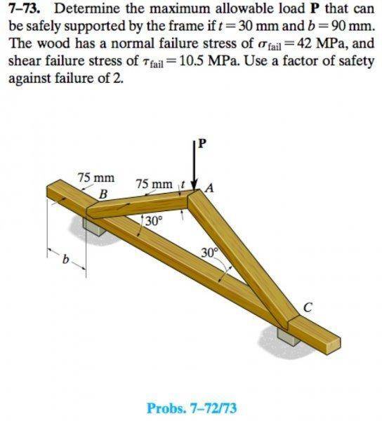

Finding the maximum allowable force P before failure
Shear /normal stress = Force / Area
I know that I can resolve the force P to be along and normal to the end of the wooden beam to find the respective forces separately,applying factor of safety, from the failure stresses given and therefore, determine which P is lower which shall be the maximum allowable P. However, I do not see there the distance b come into play. Am i missing something?
Can you show how you "resolved" P?
Pcos30 will be my shear force and Psin30 will be my normal force to the end of the beam.
Don't you mean P/2cos30 and P/2sin30?
