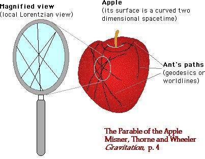

Energy in GR is unfortunately a rather advanced topic. So I don't think you'll really find an explanation that's both simple and correct for the energy part of your question.
"Geodesic deviation", which I think a few posters (such as AT and Dr. Greg) have explained via diagrams can explain the acceleration part of your question.
http://www1.kcn.ne.jp/~h-uchii/apple.html
has some information on this, you might find the posts here just as readable. A textbook reference (graduate level) is MTW's big black book "Gravitation". You can probably find a similar explanation in "Exploring BLack Holes" or in other undergraduate treamtments of GR, but I can't definitively point at one at the moment.

I mostly liked that site for figure 4. The figure you'll find on the cover of "Gravitation".
