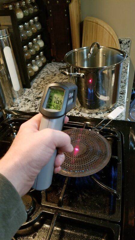

Lots of great replies in this thread - they helped me obtain a better understanding of my consumer grade IR detector. Thanks.
I had thought that these things just couldn't read a shiny metal surface. I now think I understand that it reads them just fine, but since they are "hardwired" to assume an emissivity of ~ 0.95, the displayed conversion to surface temperature is off. So if you can estimate the emissivity of the object, and apply a correction factor, you could use it for surfaces that are not near 0.95. Though I'm also reading that estimating the emissivity isn't easy, minor changes in the polish and/or oxidation of the surface cause a big change in the number. The sources I read said to do it emperically with an actual surface temperature measurement (thermo-couple) where possible.
No, you were right the first time: they do not read polished metal surfaces. Like at all. A stainless steel pot on the stove will read neat room temperature unless it sees your reflection. Somewhere on the forum there is an ir photo I posted of two boiling pots of water and you can clearly see the coated carbon steel pot's reflection in the polished stainless pot.
Here is a pot of sanitizing solution I've been using for homebrewing for a few weeks. I turned on the burner and waited 30 seconds for the warming diffuser to heat up before taking the picture. The pot is most definitely still at room temp.
Likes NTL2009
Ahhh, I see. I just tried that for myself, with just the gas flame reflecting in the SS pot, and it immediately jumps to +300F, so just reflecting any IR in the room.
So reflectivity is a big component of this as well.
