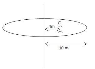

A 500kg merry go round with a radius of 10m is moving at a speed of 0.5 rad\sec. A 40kg child jumps on the merry-go-round at a position of 4m away from the center of rotation. (a) What is the inertia of the merry-go-round? (b) What is the inertia of the child on the merry-go-round? (c) What is the final speed of the merry-go-round when the child jumps on it?
##L_{0} = L_{f}##
Sol:
246243
a) inertia of the merry-go-round(disc) = ##\large\frac{1}{2} \normalsize MR^{2} = \large\frac{1}{2}\normalsize(500)(10^{2}) = 25000 kgm^{2}##
b) inertia of the child who jumped on the merry-go-round = ##MR^{2} = (40)42 = 640 kgm^{2}##
c) final speed of the merry-go-round when the child jumps on it: ##L_{0} = L_{f}##
##I_{M}ω_{0} = I_{C+M}ω_{F}##
##25000(0.5) = 25640.ω_{F}##
##ω_{F} = 0.488 rad\sec##
How ##L_{0} = L_{f}##?
The problem is not very well specified since it does not state how the child jumps on. Does the child have zero velocity? The solution seems to assume this.
Regardless, as long as there is no external torque, angular momentum is conserved.

Children's merry-go-rounds are designed to be able to spin for a while with no one pushing. The event of the child landing on the merry-go-round will be have a brief duration. Brief enough that any external torque will not have time to significantly change the angular momentum.
There is also an assumption that the bearings are good -- that the momentary load of a child landing on the merry-go-round will not cause them to seize up. In my experience with merry-go-rounds, that assumption is justified.

Since the child jumps on, the child's momentum is all that matters, regardless of how the momentum transfer spreads over time.
Yes, the question should have specified that the child jumped on radially.

A typical child's merry-go round will spin down from a reasonable speed to a dead stop over a period of perhaps sixty seconds. A typical child will land on a merry-go-round and come to a relative stop in perhaps one quarter of a second. [Or less. In one personally memorable incident I think the merry-go-round was spinning at nearly 2pi radians per second with myself standing/walking in the center. The ensuing interaction was brief but educational]
We are working with inputs that have one significant figure. Roughly speaking, the external torque on the merry-go-round would need to increase about ten-fold before becoming significant.
In any case, this is a homework problem. We have not been given any information with which to quantify an external torque and we have good reason to expect it to be irrelevant. So accounting for a hypothetical external torque must not be expected of us.
