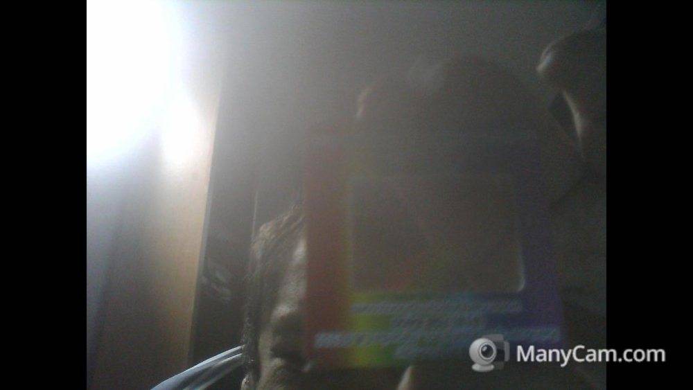

i bought a diffraction grating from a website named home science tools, this is a picture of it
any reason it won't work?
A diffraction grating is not a detector. It simply disperses the different wavelengths of light.
