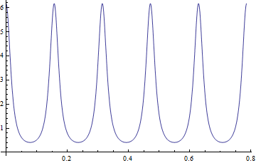

r(t)={(4+cos20t) cost,+(4+cos20t) sint,+0.4sin20t}
Calculate the curvature of r[t] for 0≤t≤4pi
k = | r' x r'' | / | r' |^3
r[t_]:={4+Cos[20t]*Cos[t],4+Cos[20t]*Sin[t],0.4Sin[20t]}
k[t_]:=Norm[Cross[r',r'']]/Norm[r']^3
Plot[k[t],{t,0,4Pi}]
I don't get any error messages, but the graph is blank.

t or t_ in the Plot function?
If you have defined a function using the "standard" form, id est, f[x_] := you do not want the x_ on the right hand side of the definition.
Now to your real problem:
You forgot to specify that the derivatives are also functions of t :)
Code:
r[t_] := {4 + Cos[20 t]*Cos[t], 4 + Cos[20 t]*Sin[t], 0.4 Sin[20 t]}
k[t_] := Norm[Cross[r'[t], r''[t]]]/Norm[r'[t]]^3
Plot[k[t], {t, 0, Pi/4}]
Haha, I actually managed to plot it, but I thought it was wrong because I wasn't expecting a huge wave.
I was also told to calculate the length of the curvature. Do you think this would be an acceptable answer?

Well, in theory you can apply //Simplify, but Mathematica has done this already, so in my opinion - no :)

Well, using the simple
Code:
Sum[k[t],{t,0,4Pi}]
I, again, receive 26.8967.
You should check the initial settings in r, because I see errors there.
For example a missing 't' in the first part :)
Check again the problem and repost what is actually given.
I can't believe I overlooked that. I also removed the parentheses. Now I'm getting 26.89. Thanks for the help
