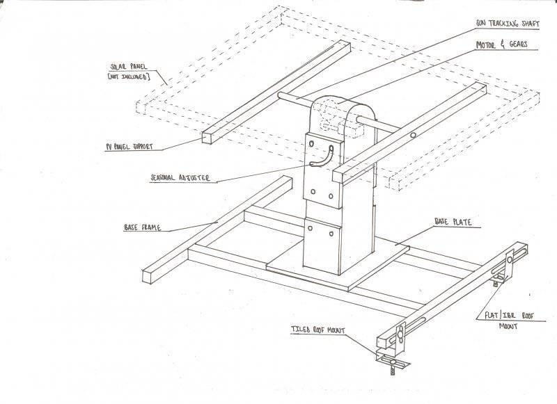

I'm busy designing a solar panel mount for a 300W solar panel, roughly 2m x 1m in size and 30kg in mass. I would like to know how to calculate the torque on the shaft (situated in the centre of the panel) when experiencing a wind force of 300 km/h.
Integrate ##r* d\vec{r}\times \vec{F} d\theta## where F is the force of the wind on the panel (you can probably google this, or model it using the quadratic drag equation with v=300km/h), w is the width and dr is the radial distance from the shaft. This will probably be zero if you assume a constant force (as long as v=300, the force will be constant). The best thing you could do is only calculate the torque for one side of the panel, that will give you the upper bound for the torque from fluctuations and the panel shaking around. This is actually more along the lines of something to the effect of a meter-torque, which makes me wonder, but I'm pretty sure that's what you want, the sum of all the torques, which on an infinitesimal scale will result in integrating the Force down r to get ##T(r)## and then around theta to sum torques.
Thanks. Having done that, I get a torque of 1450,158 [N.m]. Surely it can't be that much? Would the motor for that torque not need to be huge?

Yea, it would be pretty huge. 300 kmph winds only hitting one side. Of course, it will probably never hit that, because realistically there will be cancellation from the wind pushing on the other side, but the number you calculated is the absolute maximum torque that could ever be exerted, which is 300 kmph winds on half of the solar panel (on one side of the pivot point) and 0 kmph on the other.

I will check it out. The 300km/h wind is due to South African standards [SANS 10160-3: Structural Design for Wind]

I've looked at this standard. There are a lot of factors going into the determination of the design wind speed. Are you sure you haven't made a mistake somewhere? I find it hard to believe that structures are regularly designed for 300 kph wind loadings in SA which don't look like bunkers and which don't cost a fortune to build.
Haha I questioned this myself when I first took a look at the standards. Then contacted a peer that is busy designing a parabolic reflector, he too used a wind speed of ± 300km/h
So I have two suggestions about the wind issue. First, verify with your instructor that it really is a requirement that must be met by your design.
Second, if it is, I would suggest a shaft locking mechanism, to be used when the wind speeds exceed some reasonable amount (like 50km/hr). It is not practical for things like solar panels to be expected to continue tracking in very high winds. They would typically be set in an average position and locked for the duration of the wind storm. you might also check with the instructor to verify that this is a reasonable alternative to over-designing the tracking motor and mechanism.

In addition to the large torque, what about the structure holding up the solar panel itself? It looks rather lightly constructed, judging from the attached sketch. Is this frame even strong enough to support loads generated by hurricane-force winds? :)) :wink: :nb)
I'll speak to my lecturer about the wind speed but we were required to adhere to the standards. If you have a look at the "Twerly Street Light" [http://groundup.org.za/article/renewable-energy-streetlights-could-change-lives_1874] , which was designed in my city, it was also designed for 300 km/h wind speeds.
All the structural supports are 100%. Largest stress I got in the frame was 140MPa. Just note that the sketch is just a rough concept. My CAD files are obviously of much greater detail. Also, in my city, which is where this mount is being designed for, we get gale force winds when its sunny out, its dubbed "The Windy City" for a reason.

I don't think locking down the solar panel is a good idea. If anything, you want the panel to be free to weather vane in the wind, so that the wind pressure does not build up unduly. High winds, especially when other structures are present nearby, can change in velocity and direction quite rapidly.
If it's not feasible to permit the solar panel to weather vane, when high winds approach, then you want to enclose the apparatus inside a fairing or shelter of some sort, if nothing else to prevent it from being damaged or destroyed by any flying debris picked up by the winds.

Next Problem, since the rotational speed for tracking the sun is extremely low, average is 0.000694 rpm, and using a motor of 110 W, the torque experienced on my shaft is impossibly high. Note, this has nothing to do with the wind load, just power delivered to the shaft by the motor and gears. Any suggestions?
It doesn't output 110w constantly, that's just the max. The actual output will be determined from the variables in your power equation.
Likes berkeman
Thanks man, think I got it now
