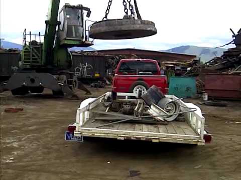

If the rods are not too thick, and you use a distance of 1m, then the large electromagnets that are used to pick up cars at wrecking yards may be able to do it (but I'm not sure):

Well, it will depend on how much do you want to bend these rods. A few angstroms at the tip would be quite different than a few centimeters.
Likes ZazendS and berkeman

Thank you for your reply. Of course you are right. I would ideally like a displacement of ~20-30cm from resting axis for the tip of the rods. Please allow me to add once more that I am still looking for the material to be used for this rod and I am, of course, looking for materials with a greater Young modulus than steel.
Well, to be attracted toward the electromagnet, the rods will have to be made of some ferrous material. Also, you will get more force and displacement if there can be a ferrous ball at the top of each rod. Is that a possibility? Like a ball about 10cm in radius...

As berkeman hinted at above, the pulling strength of a magnet decreases very quickly with distance. The video of the scrap yard magnet shows the magnet physically touching the metal parts before the metal is visibly attracted to it. This poses a problem, because there's a very fine line between not enough attraction to bend the rod, and too much attraction, which tears the rod from the base and launches it into the magnet at high speed. There's a positive feedback in attractive force as the rod is pulled toward the magnet.

Based on that budget, the updated answer to post #3 is "impossible".
