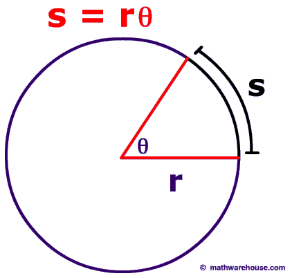

These may help.
https://www.google.co.nz/search?q=l...ChMI3KjJlpzrxwIVRRamCh00bwXM&biw=1680&bih=925
And this:

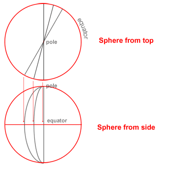

Project a line from the center of the circle straight down. This is 0 degrees.
Rotate this line left or right 15 degrees, place a vertical line where it intersects the circle. Where this vertical line intersects the equator is where the longitude is.
Repeat for 30, 60 degrees.
If you want to draw in the entire longitude you'd have to draw parts of an ellipse.
Likes Nargis Adham
What scientific601 is demonstrating is that you can start by drawing the sphere looking down on it from above. Then project those points to the face.
scientific601 has eloquently done it without needing to use an extra circle.
Likes Nargis Adham and billy_joule
