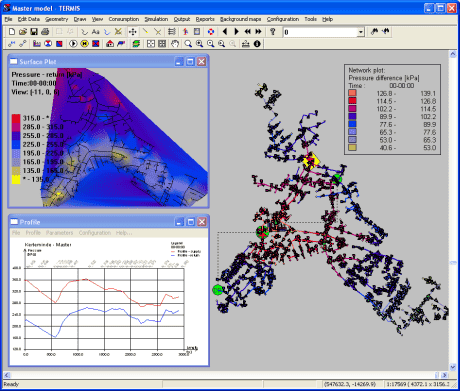

Sorry for my poor description. I need to model the network, as you indicated, in an ordinary time domain simulation (the demand/flow rate will change and I will see the pressure distribution through the network - to evaluate if the pressure difference across each end-user station is enough or not). In a further study, I will develop the thermal transients, in detail I will solve the convection-diffusion equation to see the temperature propagation through the network.
I have difficulty to find references about closed-loop networks; especially for this case that all end-user substations are parallel to each other. Since I will deal with modelling of a district heating network -such large scale-, I need a general tool/model that such as in graph theory to evaluate the pressure distribution through the network (such as the one shown in the below picture - ref: Termis(7T)). Can you suggest any reference or tool/code?

You're asking for help about writing a hydraulic analysis program from scratch? This seems like an odd request for an internet forum - I would think this is a task a small team of computer and mechanical engineers might spend a year on. Commercially available software for this is highly developed and costs thousands of dollars per license. Is this really what you are asking?
I'll second that. I wrote such a package in the 70s. The license fee back then was $35K. Alas, it no longer exists, but I'm sure others must. Be patient and some PF member will suggest one.
