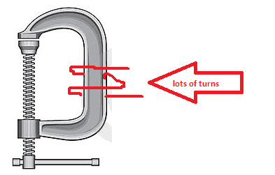

The magnetic flux should go in a circle with air gaps being as small as possible. A U shaped magnet could work.

Dr Z is right.
My 2 cents(overpriced at that)
Experiment with a C-clamp (iron one of course)
gives you a magnetic loop with adjustable air gap.
Tighten clamp and tack weld that wobbly tip to the screw so it won't flop around.
Likes Anoop Varghese
