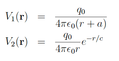

Given charge distribution, electric field and potential, find the total charge between two concentric spheres.
V_1(r) = q_0/(4pi*epsilon_0*(r+a))
V_2(r)=(q_0/4pi*epsilon_0*r)*exp(-r/c)

Using the formula for the total contained charge, I am to examine the total charge enclosed 'in all of space' in the case that r_1 ->0 and r_2 -> infinity for both the electrical fields (as such, obtaining an expression for the total charge by means of Gauss' law in differential form)
Next, I have to calculate the same quantity, only instead I use the integral form of Gauss' law directly on the fields, and then examine what happens as R tends to infinity.
These two methods yield different results, and I am not entirely sure that 1) I'm doing it correctly 2) Why the results differ.
It seems by the way the problem is formulated that the discrepancy is intentional, but I have no idea why.
In case you were wondering, i obtain q0 and -q0 for E1 and E2 respectively when I use the differential form, and q0 and 0 (the discrepancy) for E1 and E2 respectively when I use the integral form.
I really hope someone can help as I've been stuck on this for hours now.

Yes. I take it that here you are considering the case ##V_2(r)## of the problem.
This would kinda make sense to me as the limit as R -> 0 for the expression in Method 2 yields +q_0
Right. For very small ##r##, ##V_2(r)## is essentially the same as the potential of a single positive point charge ##q_0##.

Yes I am now considering the case ##V_{2}(r)##.
So my understanding of this problem is now this:
As ##R \rightarrow 0## in Method 2, this corresponds to the case where the charge density (which is negative) is non-existant as it simply has no volume.
Conversely, letting ##r_{1} \rightarrow 0 ## and ##r_{2} \rightarrow \infty ## in Method 1 is doing the opposite, effectively only counting the volume which contains negative charge density.
Thus, the integral form of Gauss' law seems the most complete, as letting ##R \rightarrow \infty## accounts for all charge

I'm not quite following this. Method 2 does not involve ##R \rightarrow 0##. It involves applying Gauss's law to a sphere of radius ##R## and letting ##R \rightarrow \infty##.
We can think of ##V_2(r)## as the potential of a positive point charge at ##r = 0## along with a negative charge density spread throughout all space. The magnitude of the negative charge density is actually very large near ##r = 0##. You can work it out using the differential form of Gauss' law. You will see that the negative charge density diverges to negative infinity as ##r## goes to zero. But, nevertheless, the amount of negative charge within a sphere of radius ##r_0## goes to zero as ##r_0## goes to zero due to the fact that the volume of the sphere decreases "faster than the charge density diverges". What this means is that in taking the limits in Method 1, you will account for all of the negative charge (while missing all of the positive charge). But maybe this is what you are saying in the following:
Yes, this sounds good.
