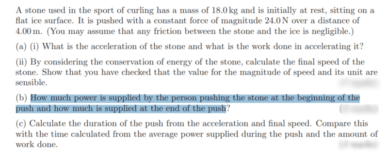

I solve question a) by rearranging the F=m*a equation, which makes the acceleration equal to (24N/18kg)=1.30m/s^2. And I find the final speed using equation W=1/2*m*v^2 and rearranging it to solve for v, which gives me a value of v=3.27m/s.
But the part of the question I am having trouble with is when it asks me to find how much power is supplied at the beginning and end of the push. How to find that? I know that average power equals change in work over change in time, but using this formula doesn't seem to lead anywhere. I guess there must be another equation I can't think of?
Anybody has a better attempt?

Did you try googling "kinematic equation for power"?
By the way, your "Relevant equations" entry is really your attempt at solution. I'll move it.

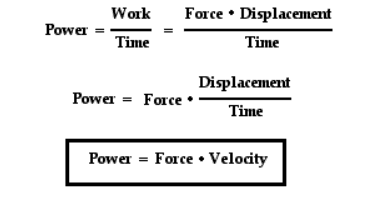

Okay, thank you.
And what are the kinematic equations for power? You mean one these 3? :
I don't know of anything else and google can't seem to help me on this.
Thank you for your help
Yes!
Take a good look at the one in the box :wink:
gneill said:
Yes!
You mean the last one? Power equals force times velocity? I tried working with that one, but how would I find the initial and final power? Should I put v equal to 0 for the initial and Vfinal for the final? But that would imply that the initial power is equal to zero, which doesn't make sense to me intuitively. I could think reason though!
Yes.
If the stone hasn't moved yet, no energy has been transferred. Hence no power has been spent.
