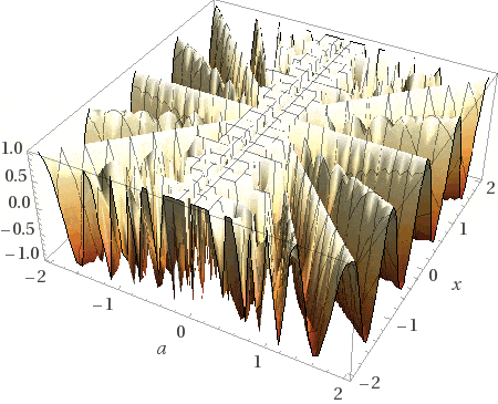

This may or may not help, but I have a graph of the integral in question.
