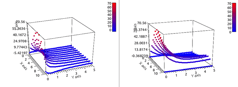

I did a stability analysis using a discrete Fourier transform, but I couldn't get the dispersion relation, because I couldn't get the amplitudes separated in the equation, but the result I've got made me think that this scheme wasn't actually stable. When I wrote the code, and run it, it didn't seem to converge pretty well, I obtain some nonphysical negative scalar flux in the numeric solution:
In the left is the analytic solution, and in the right the numerical. You can see that at the boundaries I have some negative values. I didn't use boundary conditions in the space variable, but I think I could do that, and fix the values at those points. The parameters I've used in this case are:

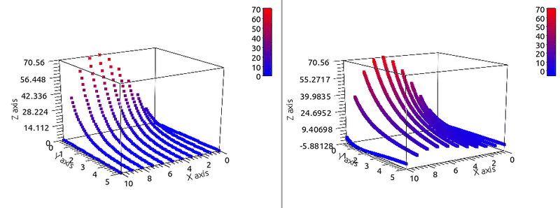

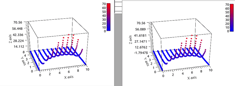

N is the number of points in space, M the number of points in time. That solution looks fine, but if I use other values of c, it gets much worse. The solution blows up after some times steps. I thought of using more points, a finner grid, but instead of getting better, it gets actually worse, which really surprised me.
Here I plot for the same grid and c=1, and c=100:
This last case is, in the left the analytical again, and in the right the numerical with:
N= 10 M= 400 xmax=:10.000 dx= 1.0000 tmax=5.0000 dt= 1.25000E-02c= 50.000
I didn't show it, but for other grids the solution explodes exponentially fast, I can't plot those cases.
