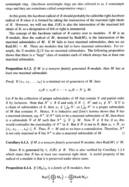

I am reading Paul E. Bland's book, "Rings and Their Modules".
I am focused on Section 6.1 The Jacobson Radical ... ...
I need help with the proof of Corollary 6.1.3 ...Corollary 6.1.3 (including the preceding Proposition) reads as follows:

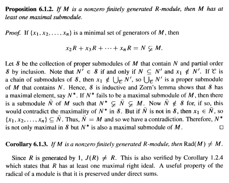

My questions are as follows:Question 1
In the proof of Corollary 6.1.3 above we read:
"... ... Since ##R## is generated by ##1, J(R) \neq R##. ... ...My question is as follows: why, given that ##R## is generated by ##1##, is it true that ##J(R) \neq R## ... ... ?
Question 2
Bland seems to argue that if we accept that ##J(R) \neq R##, then the Corollary is proved ... ... that is that
##J(R) \neq R \Longrightarrow \text{ Rad}(M) \neq M## ... ...
But ... why would this be true ...?Hope someone can help ... ...Peter

Hi, Peter,
Math Amateur said:
Question 1
I don't get it either. In my understanding a maximal ideal is always a proper ideal and thus ##J(R) \subsetneq R## is also a proper ideal. The ##1## simply illustrates it, because ##1 \notin J(R)## and so is ##J(R) \subsetneq R##. To me this only excludes the case ##J(R)=R=\{0\}##. Maybe ##J(R)=R## means there are no maximal ideals at all, but in my understanding this would only mean ##J(R)=\{0\}## rather than ##J(R)=R##. Anyway, since we have a ##1## we need not to bother.
Question 2
I don't think this is part of the proof. I think the proof is missing, because it is obvious by the proposition above. The convention ##Rad(M)=M## means ##M## has no (proper) maximal submodules, so the corollary is simply another formulation of the proposition itself: "there is at least one maximal submodule" (which has to be proper) is the same as "according to our convention ##Rad(M) \neq M \,.##
The remark ##J(R)\neq R## (as soon there is a ##1## or there is at least one maximal ideal) stands for itself (see my confusion under question 1).
Likes Math Amateur

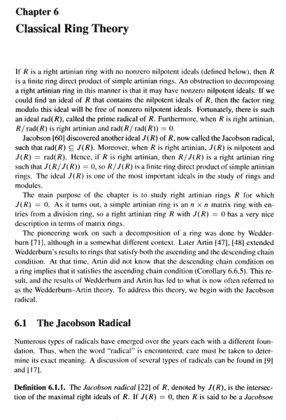

Hope Euge's answer helps ... ...Regarding the conditions ##J(R) = R## and ##J(R) = 0## ... ... ... ... I am still a little confused ...Regarding ##\text{ Rad}(M)## ... Bland is clear when it comes to ##\text{ Rad}(M) = M## ... indeed Bland's definition of ##\text{ Rad}(M)## is as follows:
"... ... If ##M## is an ##R##-module, then the radical of ##M##, denoted by ##\text{ Rad}(M)##, is the intersection of the maximal submodules of ##M##. If ##M## fails to have maximal submodules, then we set ##\text{ Rad}(M) = M##. ... ...
"Presumably ##\text{ Rad}(M) = \{ 0 \}## when there exist maximal submodules in ##M##, but their intersection is ##\{ 0 \}##Now, with ##J(R)## Bland does not explicitly give a condition for which ##J(R) = R## ... indeed his definition of the Jacobson radical is as follows:
"... ... The Jacobson radical of ##R##, denoted ##J(R)##, is the intersection of maximal right ideals of ##R##. If ##J(R) = 0##, then ##R## is said to be a Jacobson semisimple ring ... ..."Is it correct to assume that if there are no maximal right ideals in ##R##, then ##J(R) = R## ... ... ?
... ... and ##J(R) = 0## if there do exist maximum right ideals but their intersection is ##\{ 0 \}## ... ... ?What do you think?
Yes, no objections.
According to his convention with modules, and given a total analogy, it is correct, yes. I wouldn't make it for the reasons I mentioned above, but if he does, then it is correct.
