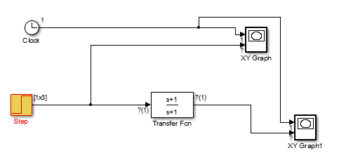

Hello,

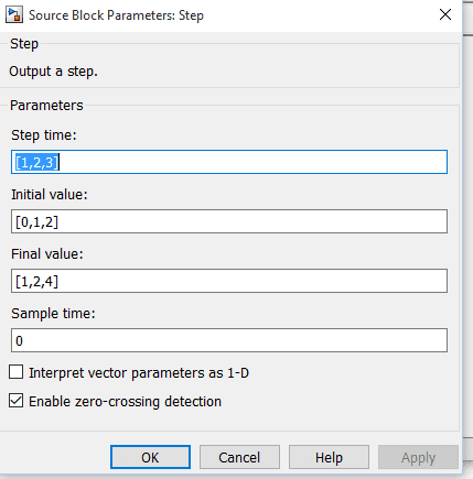

I am trying to construct the model, but I don't know how to incorporate 3 steps. I tried making 3 step blocks, but the input for the transfer function will only take one line. Then I tried to use one step block and make a vector indicating a new step at 3 different times
But this is not working, it doesn't like the vector input. Any idea how I can utilize 3 steps?
you can use a summing block and three separate step blocks.
There is also an input that will allow you to create your own waveform
Likes gfd43tg
Thanks, I didn't know how the sum block worked before, now I do.
