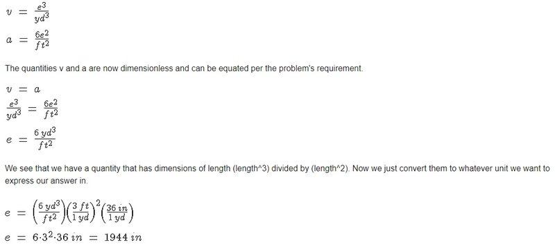

The volume of a cube is 'v' cubic yards, and its surface area is 'a' square feet. If 'v' = 'a' what is the length in inches of each edge?

zak100 said:
volume of a cube = 'v' cubic yards
= 'v' * 3 feet
= 'v' * 3 * 12 inches
= 36 'v' inches
surface area of a cube = 6 * e^2
'a' = 6 * e ^2
'v' = 6 * e^2
It looks like your unit conversions are not correct. Remember that to convert units, you basically multiply by "1"...

I'm not sure. The question is a bit strange since they are asking you to equate two numbers, even though they have different units.
So I would approach this by starting with the variable e for the length of each edge in inches.
Then I would write the equation to give me the volume "v" of the cube in cubic yards based on e, using the appropriate unit conversion from in^3 to yd^3
Then I would write the equation to give me the surface area "a" of a side in cubic feet based on e, using the appropriate unit conversion from in^2 to ft^2
And finally I would set "a" = "v" and solve for e in inches. Can you show how that calculation would go (using the hint that I gave you above for how to handle such unit conversions)?
BTW, I just worked it out that way, and seem to get a consistent answer. :smile:

Hi,
I got the solution for this problem. It can be done just by using the actual formulas instead of supposing any symbol for the edges. The solution is attached.
Thanks everybody for your time, comments and interest in my problem.
Zulfi.
I got the same answer but differently.
Let the length be x ft which is equal to x/3 yds
Area of faces in sg ft = 6x2
Volume in cubic yards = x3/27
By equating the two x = 6 times 27 = 162ft = 1944 inches

I got e = 324 inches, which gives a = v = 729. Did I misinterpret the problem?
This is what I missed. I only considered the area of one of the faces, not the total surface area. Doh! o0)
