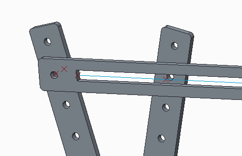

Are there any expansion joints (for example between two beams) which can carry a shear force?
The short answer is "yes," but it would help to know what your geometry is. How about a picture?
I hope the image attached is clear. I am looking for an expansion joint which allows the top beam to expand horizontally (x-direction, see image), while also being able to carry the load on the top beam.

How about if you simply top one of the columns with a flat plate and then put one or more rollers between the beam and the plate?
Calculate the expansion first. You may find over sizing bolt holes by a few mm may allow enough room for expansion.
a 500 degree delta T is only 8mm expansion for a metre length of steel (0.000016 (m/m OC)) so over-sizing bolts holes by just 2mm is all that's needed.
Otherwise, pin joins at the top two corners, pin and (horizontal) slots at bottom two.
billy_joule said, "Calculate the expansion first. You may find over sizing bolt holes by a few mm may allow enough room for expansion. a 500 degree delta T is only 8mm expansion for a metre length of steel (0.000016 (m/m OC)) so over-sizing bolts holes by just 2mm is all that's needed."
How does that work, Billy? Will you leave the bolts loose in the holes so that they can slip when the frame is heated? Looks to me like if you bolts are snugged up, friction will eliminate your expansion capability.
Yes, Don't over tighten the bolts. Just like a pin and slot join:

That's the first picture I found to demonstrate what a pin and slot join is, obviously the slot length will be not much more than it's width in the OP's case.

A humble M10 8.8 at each corner will take over 10,000kg in pure shear with a SF of 3, in most cases the material being bolted will fail before then.

If the thermal loading is cyclic (heat the structure up, cool the structure, heat the structures, ...) then there will be working in the joint (that's why an expansion joint is required in the first place). With the horizontal bolts that billy_joule has proposed, this will wear the sides of the bolt shanks. They are not hardened to prevent this, so wear could be severe.
There is also the problem of a tear-out in the structure, pushing the bolt through the side of the slot.
If the bolted joint must slip, as per billy_joule, then the nuts cannot be snugged up. This will require a second nut as a lock nut to assure that the first does not simply work its way off completely. If the nuts are snugged up, friction in the joint will possibly lock the joint, preventing the expansion motion, which was the whole point here.
Why use the bolts in a horizontal position when they could be vertical and transmit no shear at all? Let the horizontal beam simply rest on the top of the upright, and then there is no need to have bolts in shear. This is where a roller is helpful, because it eliminates the resulting rubbing.
Bolts are intended fundamentally to be tension elements. They are not intended to support shear. They support shear indirectly by putting the surrounding material in compression and letting the resulting friction support the shear.

Whether these issues are even relevant depends on the design spec.
If the joins only experiences self weight during expansion/contraction then wear will be low. If it's used once a week then wear will be slow. If the bolts cost $1 each and last 10 years then the cost of wear is low. Tear out will only occur if the rated load is exceeded.
It's just a simple cage to hold bits of Al in an oven. I've seen welders whip up more complex structures in an afternoon without even drawing a sketch - all they need to know is a few dimensions, the mass of Al and the oven temp. No need for some guy with a degree to design it!
