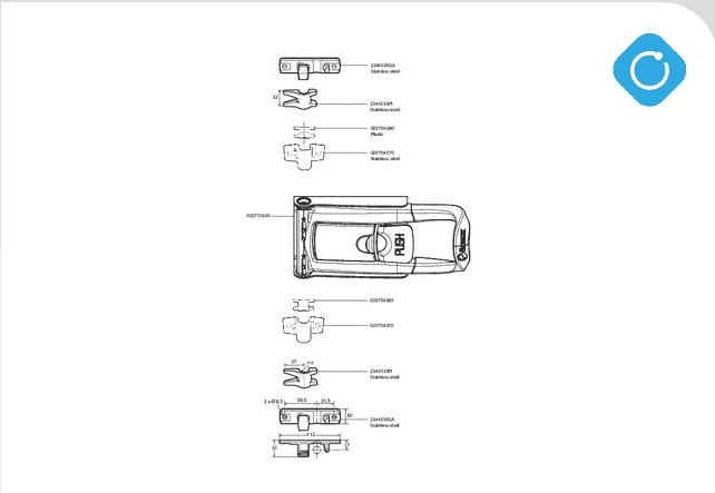

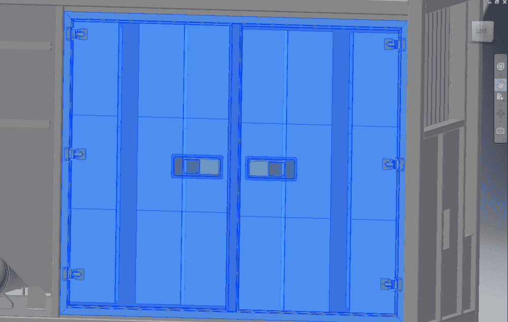

My task is to design steel container doors and its locking system. As it's a light container, locking system should be placed inside of the doors. To visualize, the container and doors looks like this. Among other things, I need to consider "gasket rubbers" (not sure if it's a right English Word for it) around the doors, extream overload caused by the weather & weaves on the ocean etc.
I'll be using locking system similar to one on the images below.

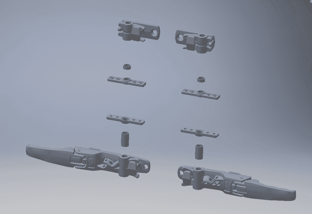

My issue is that I can't figure out how to fasten the lock's fixing to the container and keep the doors sealed.
Lock's fixingJust to visualize a bit more.
Door frame is adjustable, because we are producing the doors. However, how to keep it sealed ("gasket rubbers") and make it not interfere with the frame?

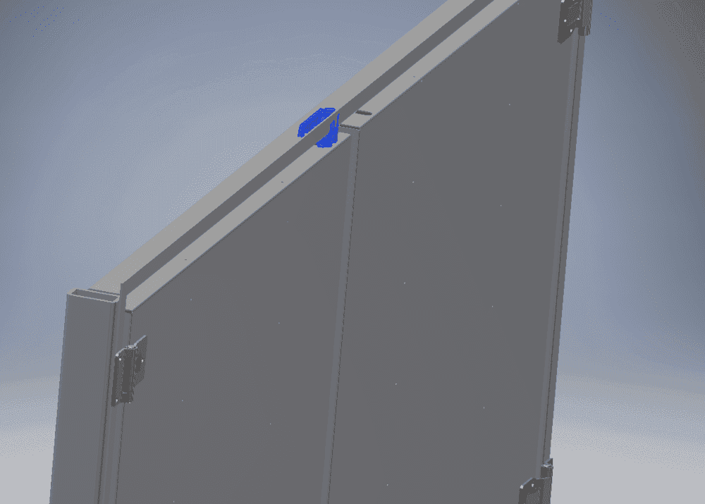

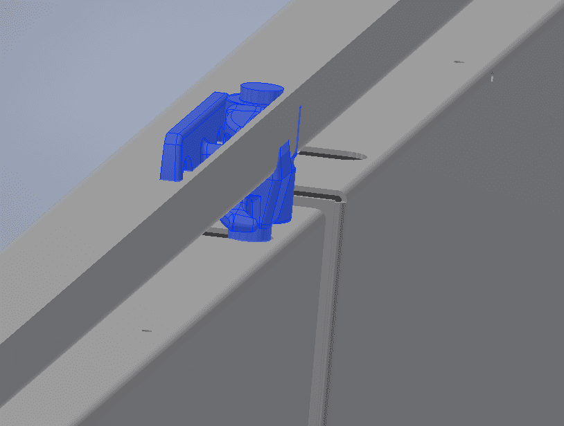

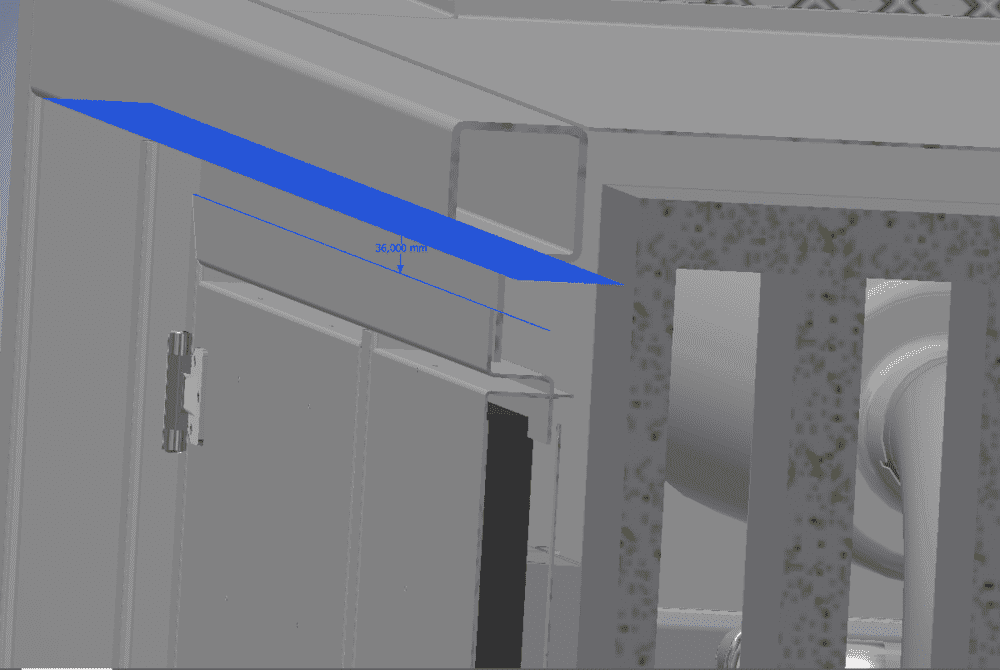

My issue is that I can't figure out how to fix locking systems keeper (thing that keep claws in a place, when the door is shut) to the frame, so it doesn't interfere with the doors frame. There are two things I've thought about. First is to make a cutout in the actuall door frame. Second is to make a frame longer (vertically), so that the keeper and claws can be positioned between the doors top and the frame. However, this second solution would make rubber seals useless on both top and the bottom. In addition, I have little space to maneuver with. (36mm from the frames top to the container structure and only 20mm on the bottom.)

The usual long lever arms give maybe a factor of 10 advantage when rotating the cams/claws. How can you get a similar advantage with the shorter lock.
