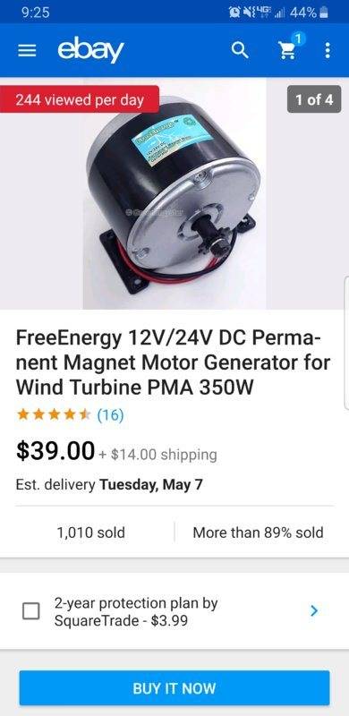

Well I have to build it but the motor I plan to use is
Generator specs are too vague.
  • "Up to 350W".
  • "12V/24V" implies two windings which would be paralleled for 12V, and placed in series for 24V, but only two leads are brought out.
  • It could be 12V is generated at xxx RPM, and 24V when operated at twice that speed, but ...
  • no speed rating is on the label, nor in the eBay description.
  • Shaft diameter is 8mm, and it comes with an 11 tooth sprocket, but no mention of chain pitch. Will this sprocket work with your bike chain, or will it be necessary to replace it for one that does?

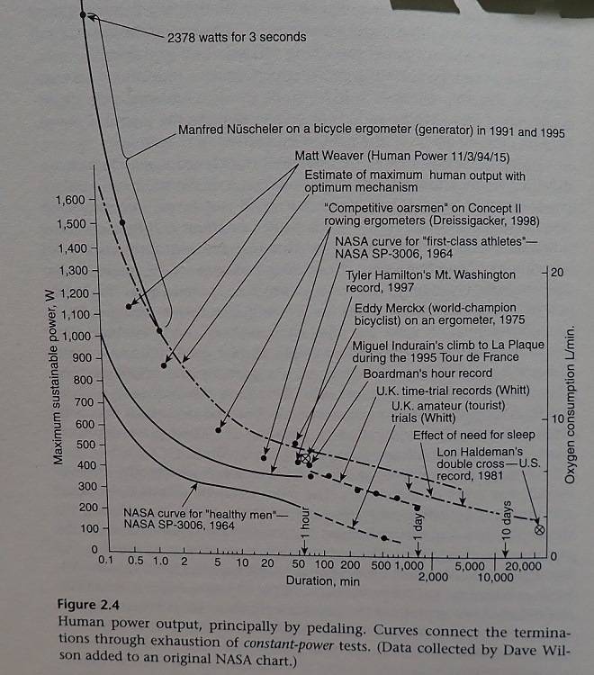

Here's some more data on cycling power vs time for healthy and fit men:
It's from Bicycling Science, Third Edition, by David Gordon Wilson. Actual electricity delivered from a generator will be less because of generator efficiency.
The above data is also from people pedaling at their best efficiency RPM. Careful selection of gear ratio is necessary when driving a generator because pedaling efficiency varies with RPM. This book is a good read for anybody interested in human power from pedaling.
Likes sysprog, berkeman, Asymptotic and 4 others

Per the very helpful curves posted by @jrmichler you should shoot for about 200W power from you pedaling for about an hour. That's assuming that you already ride a good amount of miles per week on the roads.

Just to clarify a bit -- if @Renewable_energyguy generates 200w for an hour steadily, he gens 200wh during that hour; i.e. he gens 200wh/hr, so if he pedals continuously for multiple hours at that rate, and he wants to charge a 100ah 12v battery, he'll need 6 hours of pedaling to get it fully charged.
