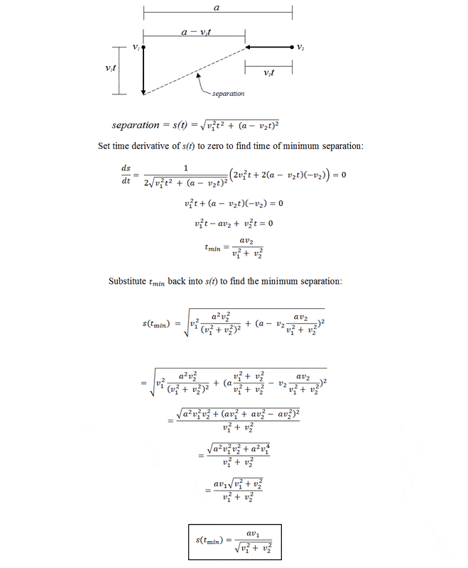

What is the minimum distance between two vehicles moving perpendicularly toward each other?
d = vt
Below is my solution, which I'm not sure is correct. Hopefully the picture shows clearly what I'm trying to find.
Likes Delta2
Looks good to me. You can also see that the limits ## v_1\rightarrow 0 ## and ## v_2\rightarrow 0 ## make sense.
If you read the question literally, the answer is obvious. But I don't think that's the answer they're looking for.
