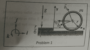

Minimum Vo for a hoop to get to the top
In summary: The problem with those two conservation laws here is that you have an unknown impulse from the step. So you need to find a way of applying one of them in which that impulse makes no contribution.
If you knew the direction of the impulse you could consider momentum orthogonal to it; but you don't.
Angular momentum is always relative to some chosen axis. Can you choose an axis such that the impulse has no moment about it?
