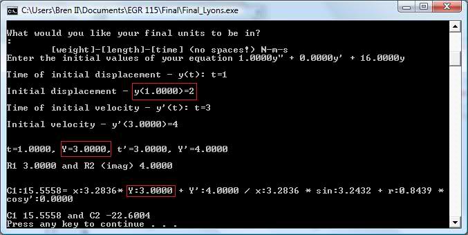

Ok so now I encountered a 3rd problem. I'm truly puzzled this time. I guess its only because I'm really not used to C.
Please bare with the slightly lengthy printf's

    printf("\n\nt=%.4lf, [B][COLOR="Red"]Y=%.4lf[/COLOR][/B], t'=%.4lf, Y'=%.4lf\n\n",[COLOR="Orange"][B]IVP[0][Y_T][/B][/COLOR],[COLOR="Red"][B]IVP[0][FUNY][/B][/COLOR],[B][COLOR="Orange"]IVP[1][YP_T][/COLOR][/B],IVP[1][FUNYP]);
coeff[0]=(coeff_solv*IVP[0][FUNY]+IVP[1][FUNYP])/(coeff_solv*sine+solution[IMAG]*cosine_yp);  //step 1 solve for C1
    printf("\n\nC1:%.4lf= x:%.4lf* [COLOR="Red"]Y:%.4lf[/COLOR] + Y':%.4lf / x:%.4lf * sin:%.4lf + r:%.4lf * cosy':%.4lf\n\n",coeff[0],coeff_solv,[COLOR="Red"][B]IVP[0][FUNY][/B][/COLOR],IVP[1][FUNYP],coeff_solv,sine+solution[IMAG],cosine_yp);
So this is what showed up. Please note Y:
The most obvious problem is that you've overflown your array.
double IVP[1][1]={0};
This declares a two-dimensional array whose first index set has length 1, consisting of the interval [0,1). I.E. the only legal first index is 0. Similarly, the only legal second index is 0.
