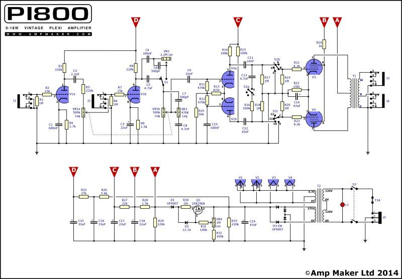

I have built several guitar amps, but the last one I built burned out a capacitor, can anyone think of a reson for this? it was an eloctolytic, all is working fine now I replaced it.

Ok I can't up load the scematic but here is the address for ithttp://www.ampmaker.com/infocentre/thread-140.html
Got it, it is c19 that blew in the power supply, sorry to have messed you guys around.

What's the voltage rating of C19? Did it blow up at first power-up (maybe installed backwards)? Or did it fail after some amount of time? What did it look like after it failed (expanded pressure relief area on top?)?

it should have a rating of at least 400V as it's going to have ~ 300 - 350V across it
Is your one at least 400V ?
275v RMS == 390v peak on low load.
I'd want a 500v rating for that cap.
A transformer specified as 275 Vrms will actually give 5% more when there is no load on the secondary.
275 Vrms * 1.05 = 290 Vrms.
290 Vrms * 1.4142 = 410 Vpeak.
450 Vdc is the next higher voltage rated electrolytic capacitor.
The mains voltage may also be higher than expected by 5% or so.
At full power the ripple current will be higher than load current by maybe a factor of about 10.

Yes it's 500v, installed the correct way and it blew after about 2 days working, the cap had a slight bulge to one side.

Who made it?

Baluncore mentioned 'Ripple Current'. That is often the straw that breaks the camel's back in electrolytic capacitors. It causes dielectric heating; ultimately raising the temperature of the capacitor and 'aging' (or 'cooking') it. I've seen many designs where a capacitor was of the correct voltage and nominal capacitance, but not rated for the ripple current heating that it would experience. Using a higher-than-required voltage rating is an imprecise (but often effective) way to survive high-ripple situations. Or, one could completely understand what is required of a part (before selecting it). This behavior is one of the most significant differences between an ideal and an actual capacitor.

Electrolytics commonly fail from excess heat over time. A possibility is that the voltage rating was too low. Another is that it was leaky as manufactured, or you used a very old one. Another possibility is that a rectifier is leaky giving it AC current which causes heat. Also if the capacitor value is too low it will get hot from the ripple current. Electrolytics are polarized so if you wired it wrong that could be the reason.
