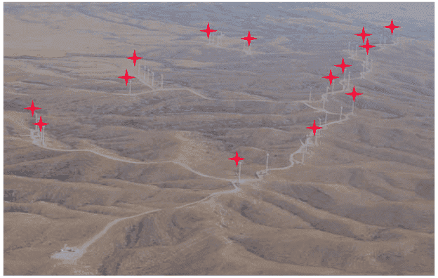

There is a large wind farm near my father's farm. Two problems that mean NIMBY for me.
Low frequency noise. It is there, and it get's to you (it does me anyway). And I suspect it varies in a high density field in a way that is non-linear. I'd be curious if these are worse or better in that regard.
For some probably idiotic reason there are huge FAA type signal lights on top of each one. And they all blink on at once. We pondered and pondered how this is achieved, and the why.. but the effect at night is... frankly hellish. I couldn't live with it. Good only if you wanted read a book to Satan, three words at time.
Those concerns aside (problems that need to be solved), I am gung-ho for wind power, and re-newables in general.
To avoid a Cessna getting sliced? Not sure why synchronized though.

The idiotic part is how ridiculously bright the effect is. Not the fact there are signals on them. Of course you need to make it hard to fly a plane into them accidentally. And I can imagine the sync is because the pilot's eye needs to build a silhouette, or something like that, which would not be served by other patterns. But the effect on the ground is pretty brutal. My sense is that it would probably work to just reduce the luminosity. It's just not a light scheme tuned to the use case - which is the kind of stupidity that kills good ideas.
Can you post a photo? Would be interesting to see.
I suppose there are Codes about this sort of thing. Maybe someone has screwed up.
My guess was that someone looked up the code, and it was for a pole over x feet high, = y-lumens and z-frequency. I think you could put a (much) fainter non-strobing light on them, and it would probably be just fine, maybe safer, and maybe even pretty. The spinning of the blades makes them "strobe" to some degree but it's a fairly random effect. That's what had us confused about what we were seeing for awhile. But it became pretty clear they are synced.
I've emailed to see if he's got a video.

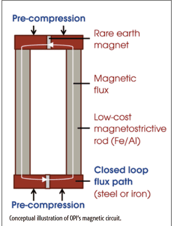

What does the actual power conversion device look like in this (waves / vortex wind) case? It isn't a regular alternator is it? There's no rotary motion but more a linear oscillation.
Do we have the converse of a linear motor? In this case they say it is moving part free so I suppose the don't even have any conversion of the oscillation to a rotary motion.

In general the motion is converted to a traditional rotary motion for a number of reasons, but cost, efficiency and availability are big. Any back and forth motion develops mechanical stress, more so than the rotating machines( even humans - there are 6-7 hour bike races but not too many 5 hour running ones). As for the circuitry - typically convert to DC and then invert to AC for Grid tie... really is no magic there - complexity adds cost. To "spread out" the load just means you are adding silicon, increasing cost and in many cases losses.

My guess was maybe something like they use here.
  • #34
Their website is pretty vague on the power conversion technology. But I only looked a little. Wonder if there are any papers out there attributable to founders etc.
They claim no moving parts, No friction.
Mabye it's a magnet that just wobbles in an electro-magnetic field? The mechanical resistance powering the oscillator would really be contained in the stiffness of the pole (pretty durable right)? And the main mechanical action would be in immobilizing the fulcrum of the pole (also pretty simple and likely durable)? But it does seem like it would be a very dirty signal, unless the oscillation is attracted to some stable period above a minimum level of input, and zero below.
Put up a few of different sizes, connect their fields, hmm...
